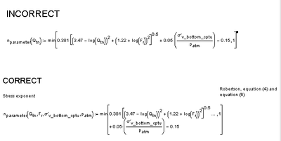

Hi
I found the error in the program. The error was in the function of the n-parameter.
As attached is a sheet with the working iteration process to all values in the vectors.
Thank you all for your help.
