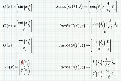

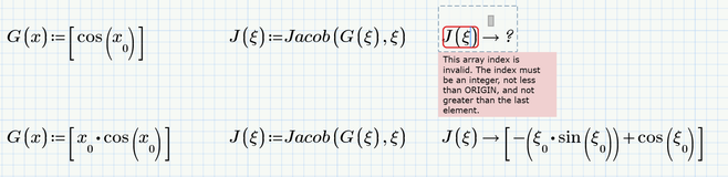

Whilst playing around with a Newton-Raphson solver for a simultaneous set of functions, I noted a disparity between the Mathcad 15 and Mathcad Prime 7 results for the Jacobian of one set of functions.  To eliminate the possibility of other parts of the worksheet contaminating the environment, I copied the function to a blank worksheet.   Unfortunately, I get the same results.
Why is the derivative d/dξ for just cos(x₀) yet isn't when multiplied by x₀??
Mathcad 15 returns the result I expect.
  1. Does this happen in Mathcad Prime 6 under the legacy symbolic engine?
  2. Is there a valid reason why this MP7 behaviour occurs?
  3. If so, should it?
  4. If not, is it a bug?

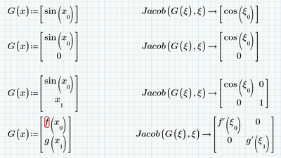

Reason for not working when I simply evaluated the regions after switching to the legacy symbolic was that I also must evaluate the definition of G(x) from anew. Not sure why.
Here are some other observations - and yes, I'd call i a bug.
"New" symbolic:
Legacy symbolic

When I copy the expressions AFTER having switched to the legacy engine, I get
"New" symbolic:
Legacy symbolic
"New" symbolic:
Good stuff, Werner.  Let us hope some kindly PTC/Subscription individual makes it known to the Symbolic team.
