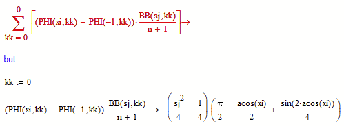

Thanks for taking a look and for your suggestion. I must be doing something wrong because I get "division by zero" when I try to evaluate SS symbolically. The problem seems to be the first term, but it is ok if I evaluate numerically. I can't figure out what I am doing wrong (updated MC 11 worksheet is attached).
RHS is the problem in the Jacobian. When I try to evaluate it symbolically I get the "pattern match exception" error.
Are you using MC15 or MC11?
In MC15 the sum seems to be implemented somewhat differently as in MC11 - maybe this causes the problem.

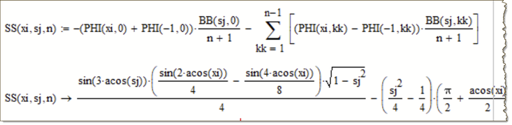

Anyway, in MC15 it throws the division by zero error when using the sum (at kk=0) while the expression itself works OK.
So maybe this workaround (for n>1) works for you:
Actually, I am using MC 14 (I posted MC 11 for Luc).
Your suggestion worked. Thanks. And MC also was able to evaluate disp(F,xi,n) symbolically although it took quite a while. That still leaves me with the problem of RHS, which gives me "must be a scalar" when I try to evaluate symbolically. Unless you have some clever suggestion, I think I need to modify the formulation (and I am not sure that RHS enters the Jacobian anyway since Y enters only in the conditional).

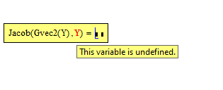

I still get
when I try to evaluate the Jacobian. so I did not even get the opportunity to be patient. Do I still have something wrong. (I corrected the use of m in Gvec. So it is now used)
Nevermind. Stupid mistake!
You can't evaluate "Jacob" numerically unless you define Y with specific numeric values. You rather will have to use symbolic eval.
