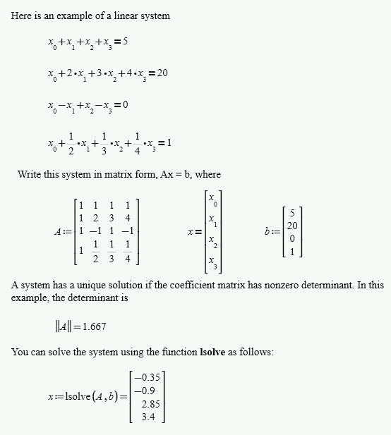

Numerically should be no problem. For the cubic solution use the root() function or a solve block.
For a set of equations use lsolve() or a solve block.

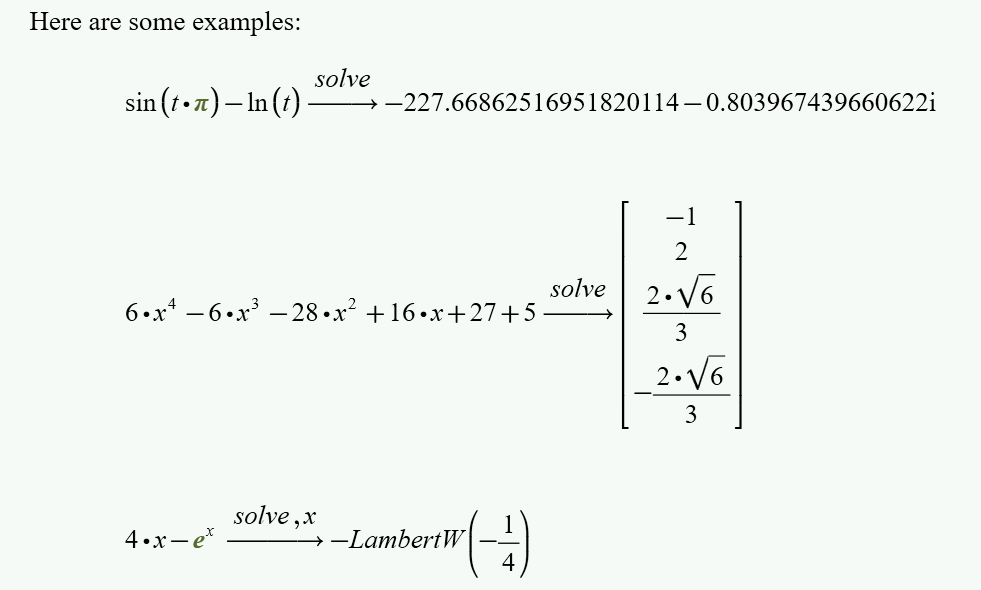

Symbolically try this:
(That is:
and this:
(That is:
