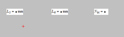

Hi, I'm having an issue where the vectors in the image below con't calculate into a result. The second image is the one where the results should be. I'm using Mathcad 20, so it's pretty old, and the original author of the workbook isn't around anymore. I can't see anything glaring and there was definitely a result from the workbook at some point.
If anyyone can help it'd be greatly appreciated!

I opened your sheet with Mathcad 15 M050 and I can't duplicate the effect you experience.
When you open a worksheet in Mathcad and auto-calculation is turned on, the visible part of the sheet is automatically recalculated.
So when I scroll down to the end of your sheet, I see this:
What do you see/experience when you press F9 or Ctrl-F9 ?
When you type 2+3= in that very sheet, do you get the answer 5?

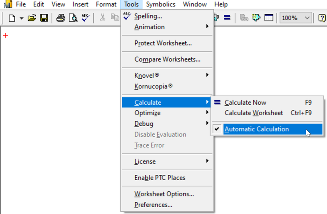

My first guess would be that auto calculation may be turned off.
If thats the case, you may either turn it on or press Ctrl-F9 to force the sheet to recalculate.
Thanks for the speedy reply! Automatic calculation is turned on. I have attached the sheet below for examination.

I have tried both F9 in both the equation an result region with no luck and with ctrl-F9 too.
I have tried to evauluate L.5 directly below the equation, which doesn't work either.
My particular version is, Mathcad 14.0 M020 (14.0.2.5 [802141434]). I cannot see any known issues like this for arrays in the known issues section for M14 M20 either.

Just found this:
https://www.eng-tips.com/viewthread.cfm?qid=245194
Looks like you are experiencing a bug in Mathcad 14 which was fixed later. There were releases M030 and M035. As far as I remember M040 was planned, but then released as Mathcad 15 F000, so people with a perpetual MC14 license would have to pay again for the software.
Unfortunately no solution is provided in that thread mentioned above. Continuously pressing Ctrl-F9 seems to work for the guy who answered there but it does not for you as you wrote.
So it looks that your only options are upgrading or downgrading your Mathcad release if ever possible.
