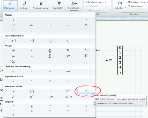

1) When you define the range "n", don't follow the definition with an inline evaluation but rather evaluate "n" in a separate region. Using the inline evaluation turns the range into a vector which can't be used as a matrix/vector index (see below)
2) Prime offers two subscripts/indices and you used the wrong one throughout. You used the literal subscript which you als get using "Ctrl -" which is just part of a variable name. Thats also the reason you could not simply use "x" of "F" as in the example because you got the error message that the variable is not defined.
You have to use the vector/matrix index instead. Doing so defines vectors "x", "F", etc. and not simple scalars.
3) You had a typo when you defined "int". You wrote "n" instead of "w".
Once these errors are corrected you get the desired result as in the help pages.
Corrected sheet in Prime 9 format attached

Hi Werner_E,
Thank you a lot for your quick reply and explanation.
Now is working.
