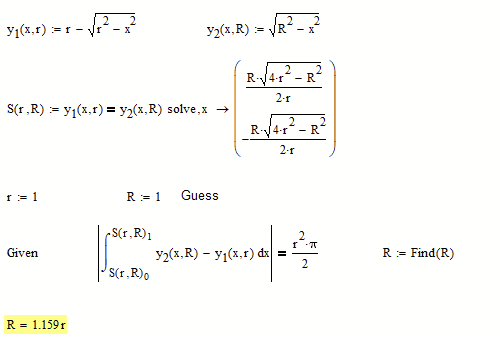

I wasn't aware of this new exact solution to the problem - thanks for bringing this to our attention.
Obviously we cannot expect Mathcad to give us the "exact" solution, but it sure is good enough for an approximation:

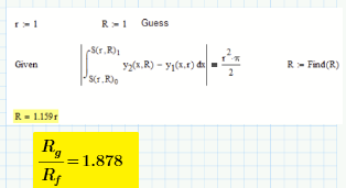

Okay, where's my mistake?

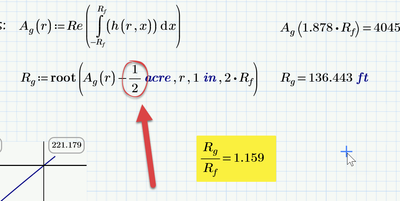

It here, as the area should be just half of the area of the fenced circle.
BTW, your function A.g(r) only returns a correct result for the area between the two circles if r<=sqrt(2)*R.f.
If the goat circle intersects the fence circle above the x-axis, you get wrong results.

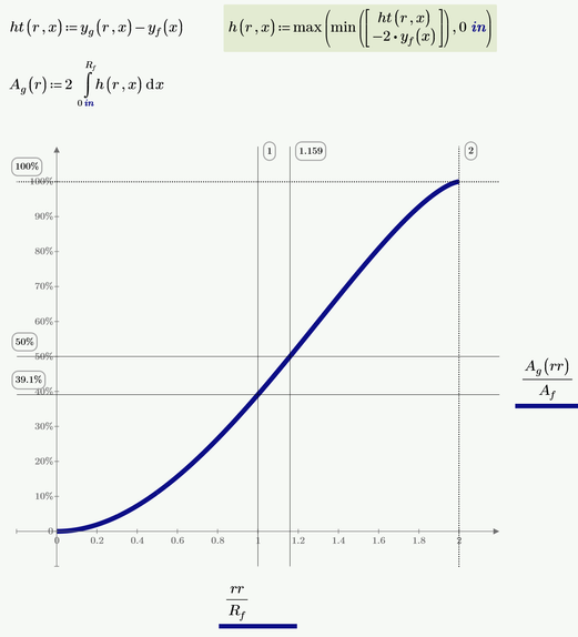

If you use "min", you may also use "max"
This modified function "h" works at least OK in the range which is interesting.
This addition should do the trick (you may check using the formula Valery has given in his sheet):

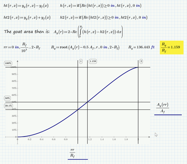

P6 sheet attached
EDIT: Had not seen your final version when I started my answer. Nice idea to use the min function and more elegant compared to my brute force attack 😉
Nice idea to make the area ratio selectable.
