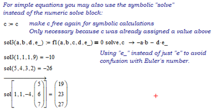

The question is already four months old, but if there is still interest, find attached a way which uses your example and also a way to use the symbolic solve command instead of the numeric solve block.
MC15 worksheet attached

If you set up your Given/Find block as  function--Ans(x):=Find(y), then below the solve block Ans(X) = will run the solve block for that value (X) and return that solution (Y).  This function can now be embedded in a for loop to return a series of solutions.
