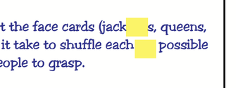

EDIT: Had to exchange the pdf file for one created by a different program because the one created using Primes "Save to pdf" option had some strange errors like (erroneous spaces highlighted in yellow by me)
