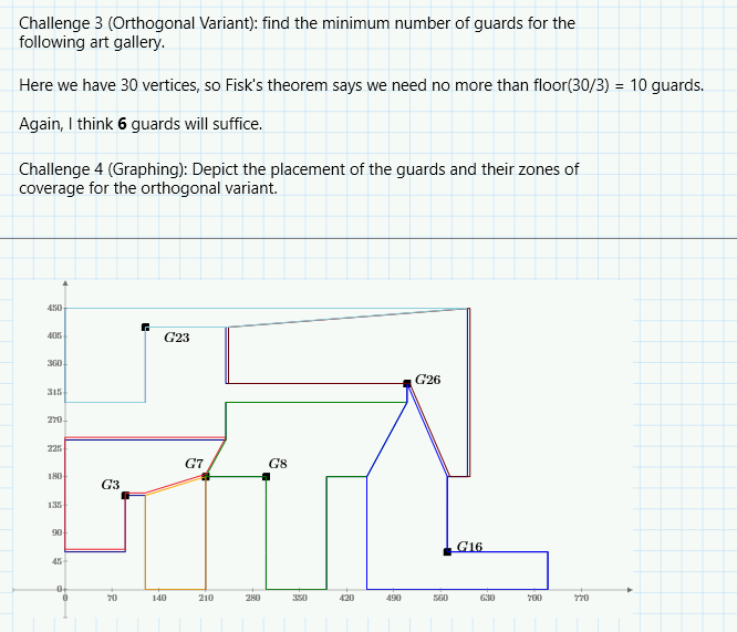

Challenge 3 (Orthogonal Variant): find the minimum number of guards for the following art gallery.
Challenge 4 (Graphing): Depict the placement of the guards and their zones of coverage for the orthogonal variant.

Here's a similar approach to the Orthogonal case:
As before, the positions of the guards is not unique, and I haven't indicated overlapping fields of vision.
In both cases I just used a visual approach, as I haven't figured out an algorithmic one.  I'd be interested to see if there is one.
It's not clear to me if the question is looking for a positioning with minimal overlapping fields of vision - if so, I haven't tried to find that!
I guess the last part (Challenge 5) will require the actual calculation of areas - something I've tried to avoid so far!
