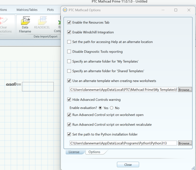

Did you set the options here?
(The last one)

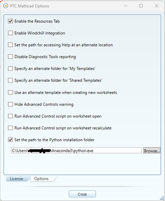

I didn't have the option selected, and contrary to the wording, it wants the path the executable instead of the folder.

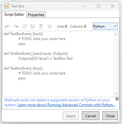

However, I am met with the following error in the advanced controls dialogue box.

This is what my "options" tab looks like.

When I compare your screenshot with that of @DJNewman  I notice that his only shows the path to (without the closing "\" and without "python.exe"), but not the executable itself as in your screenshot.
You may try to include the path to the executable (only the folder) in the Windows PATH variable and then try a reinstall of Prime. It should(!?) automatically register Python for use.
But then, maybe PTC support has a better idea or is aware of any problems and knows a workaround.
Without reinstalling the software, because I am required to get IT to do all things requiring admin access, I can say that removing the "\python.exe" causes MathCAD to catastrophically crash just like before. I will just have to open a new ticket.
