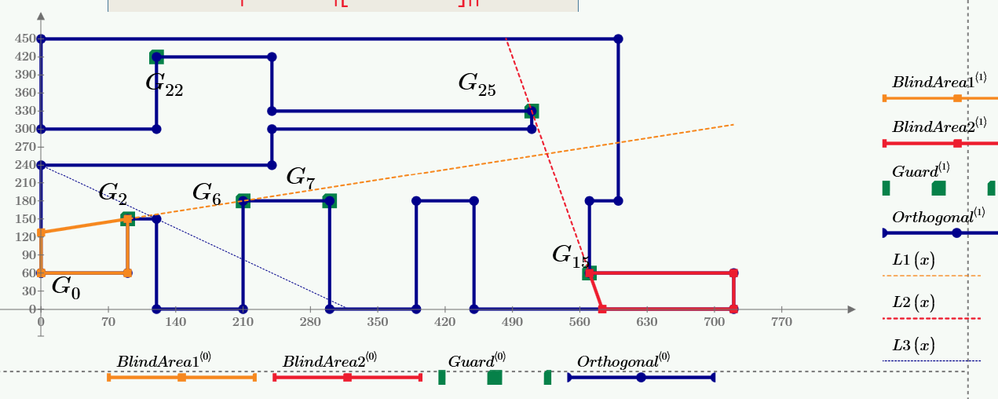

Challenge 3 (Orthogonal Variant): find the minimum number of guards for the following art gallery.
Challenge 4 (Graphing): Depict the placement of the guards and their zones of coverage for the orthogonal variant.
Challenge 5 (Basher Tarr variant): You are the tech expert for the Ocean’s 11 crew. Your job is to remove one guard to leave the maximum amount of exposed area. Which guard do you remove in either of the scenarios?

There seems to be an error in the vertices table. Although a number of dimensions are missing in the Creo screenshot, fortunately the relevant one is specified:
