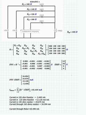

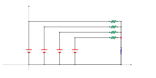

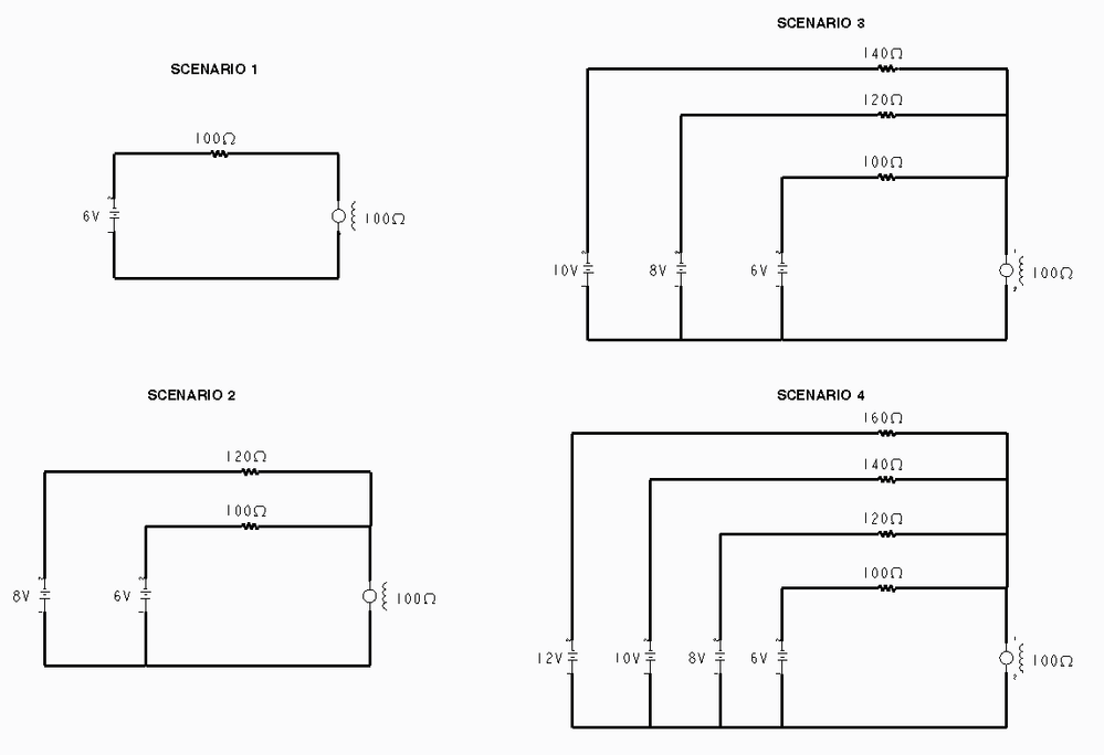

This month’s challenge is electrical engineering related, but with multiple voltage potential sources in addition to resistors. See the image below.
Scenario 1. We have a circuit with a motor (modeled as a 100 Ohm resistor), a 6V voltage source, and a 100 Ohm resistor. Calculate the current in the motor and the resistor.
Scenario 2. We add another loop, with an additional 8V voltage source and a 120 Ohm resistor. Calculate the current in the motor and the two resistors.
Scenario 3. We add another loop, with an additional 10V voltage source and a 140 Ohm resistor. Calculate the current in the motor and the three resistors.
Scenario 4. We add another loop, with an additional 12V voltage source and a 160 Ohm resistor. Calculate the current in the motor and the four resistors.
Note that these situations cannot be reduced to a combination of series or parallel resistors. There is a principle called Superposition you can apply instead.
I’m looking forward to seeing what Mathcad techniques can be applied to this problem!
Maybe I misunderstood the goal, but why shouldn't we be able to use basic Kirchhoff?

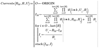

(To:Werner_E)

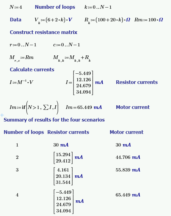

Here is a Prime function to work with resistance- and voltage-vectors of arbitrary length
My Attempt:
Prime 4 Express solution attached
Modified to add explanation.

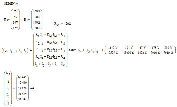

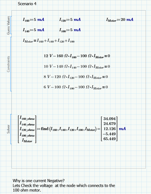

Prime 8 Express Solution:
Using Solve Block

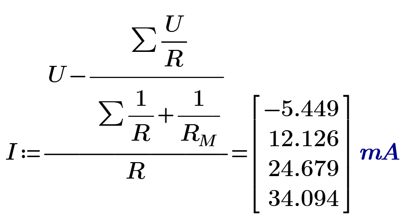

Millman's theorem for node voltage analysis. Prime 8.

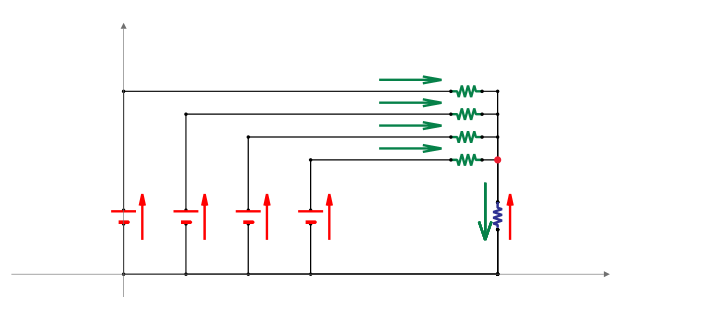

With circuit.
ttokoro
(To:ttokoro)
Add arrows.
ttokoro
(To:ttokoro)
The one of Prime 9.

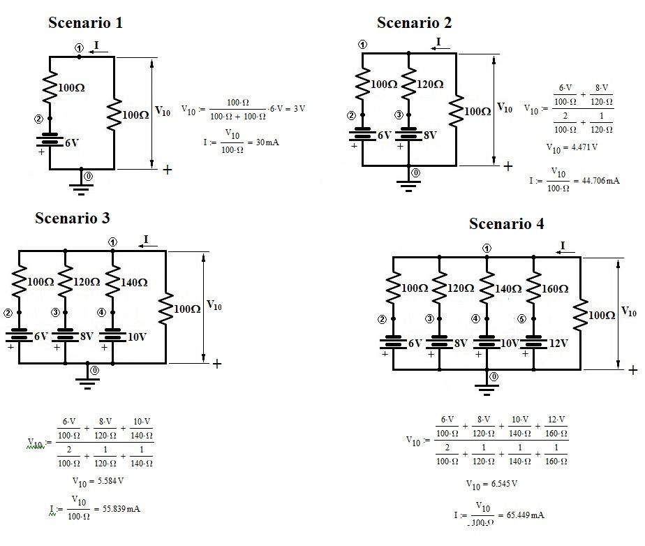

(To:DaveMartin)
Hello everyone!
In scenario 1 I applied the voltage divider formula, in the other three the Millman theorem.
-MFra-

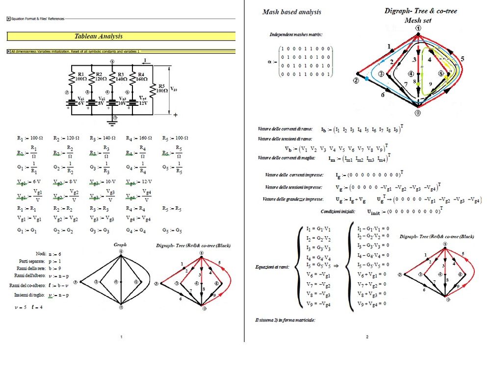

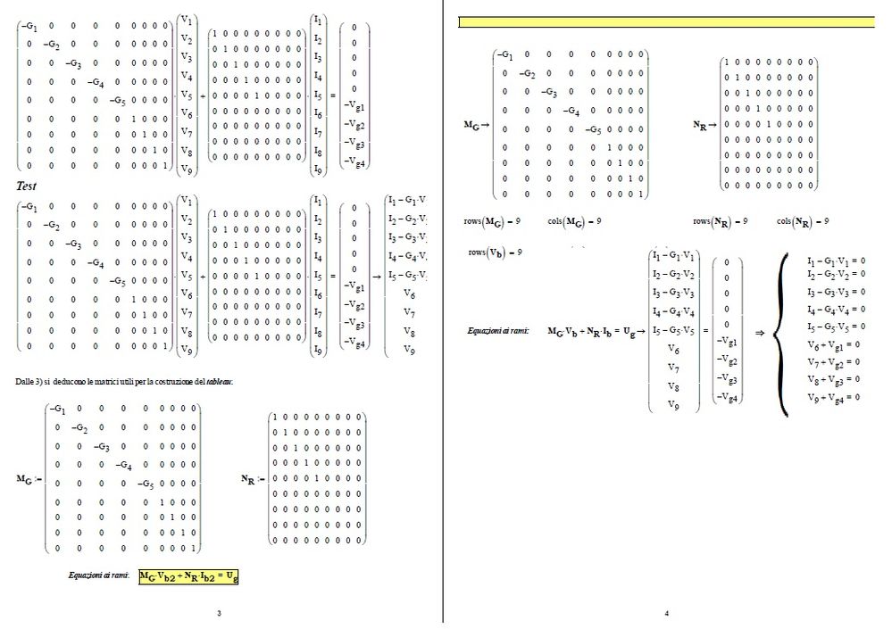

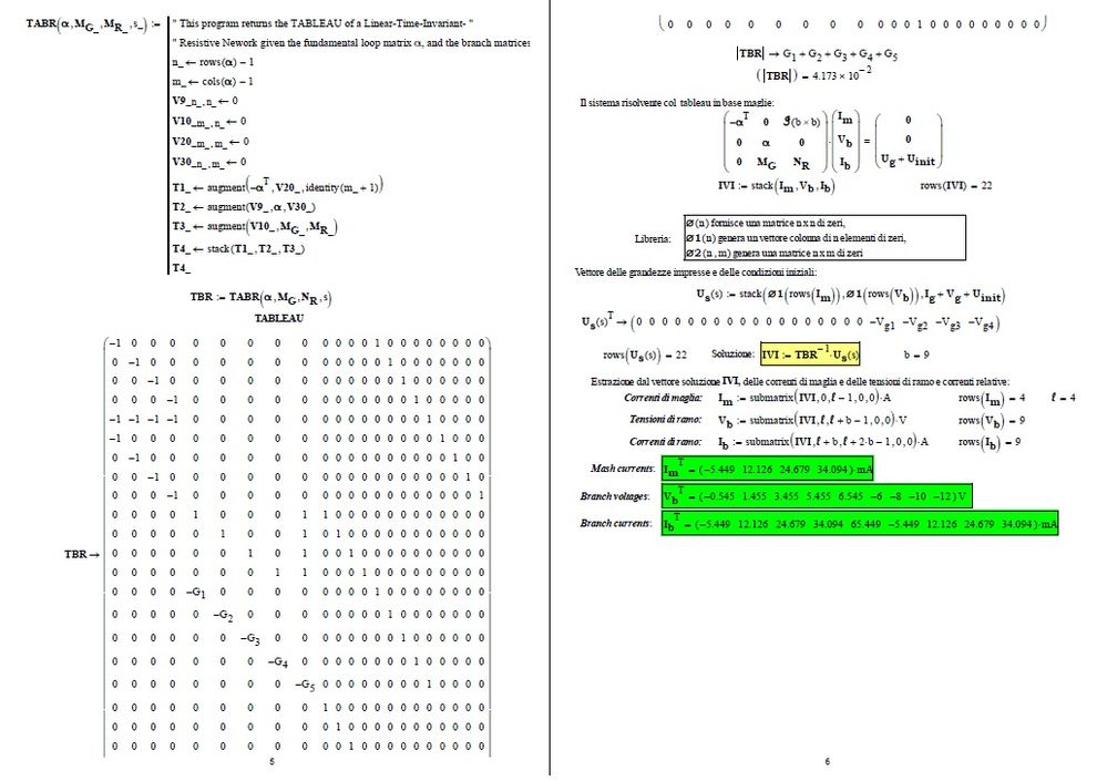

(To:DaveMartin)
Hello everyone!
I present a method of analysis of linear electric networks, of great generality. (File .xmcd attached).tableau0.jpgtableau1.jpgtableau2.jpg
-MFra-
(To:-MFra-)

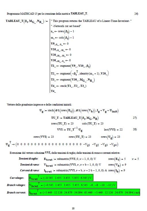

Network analysis based on cut sets:
-MFra-
(To:-MFra-)
It apply to resistive networks  only.
-MFra-
(To:-MFra-)
In the worksheet I attached earlier, function ∅1 was missing. Now I have added ∅1 to the new worksheet attached here below:
