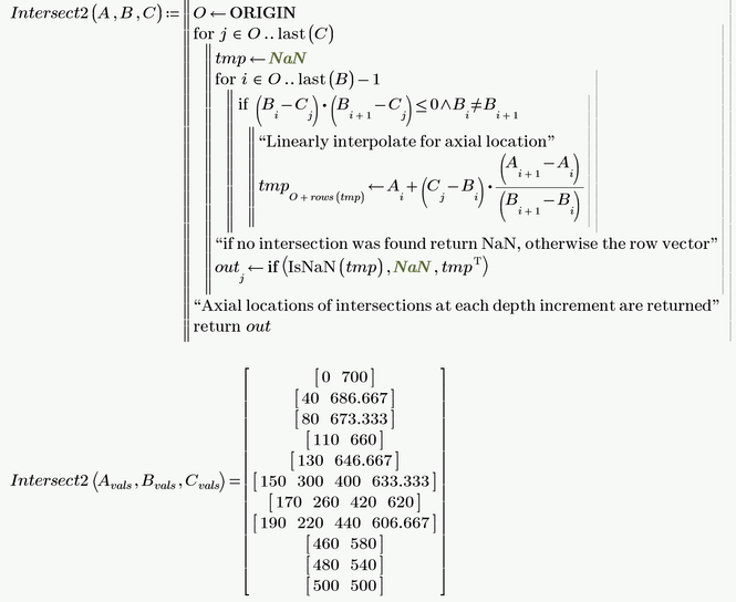

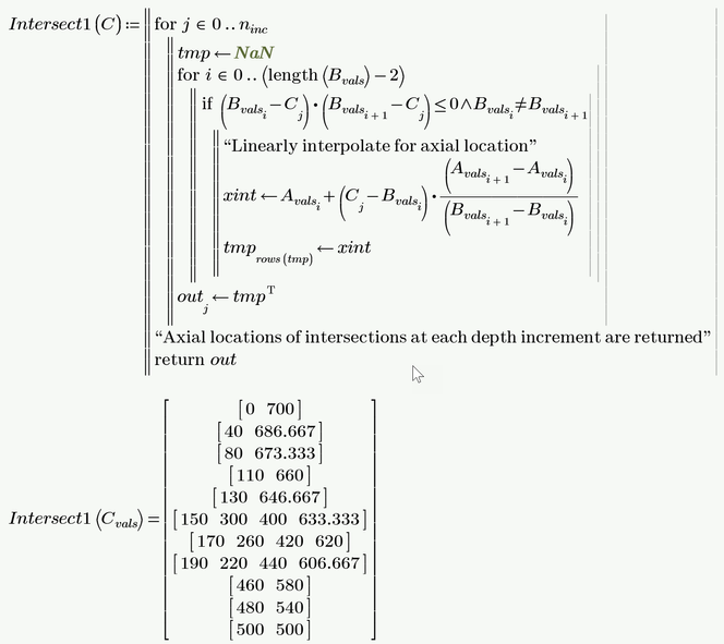

I would like some help to develop a loop in Mathcad that appends each intersection point between a piecewise linear curve and a set of straight lines, to the piecewise linear curve matrix. The attached Mathcad Prime 11 file contains the details and a fuller explanation of this request for assistance.
(To:RE_12882698)
Here is your program fixed :
But I would rather prefer to make the program self-contained, independent from the existence of global worksheet variables ninc, Avals and Bvals. And it may also be a good idea to make it ORIGIN aware so that it does not rely on ORIGIN being set to zero:

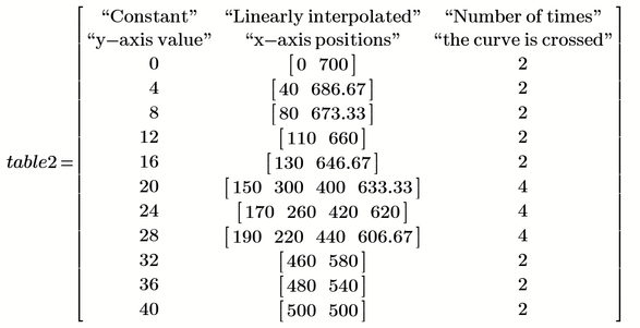

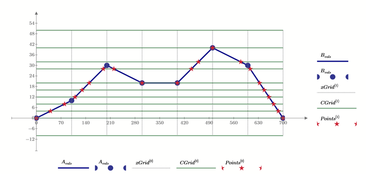

You now can create a table similar to the one in the picture embedded in your sheet
or you may create a plot showing all the points of intersection
For the plot I had replaced two values in the C-vector to test my function in case a horizontal line is too low or too high and does not intersect the graph at all. Therefore the lines at height 24 and 36 are missing as they were replaced by lines in height -10 and 50. In this case my program returns a simple NaN instead of a row vector with x-values.
I am aware that you wrote that this case never occurs in your application, but I believe that a program should always be able to handle all possible cases whenever possible (provided that this can be achieved with reasonable programming effort).

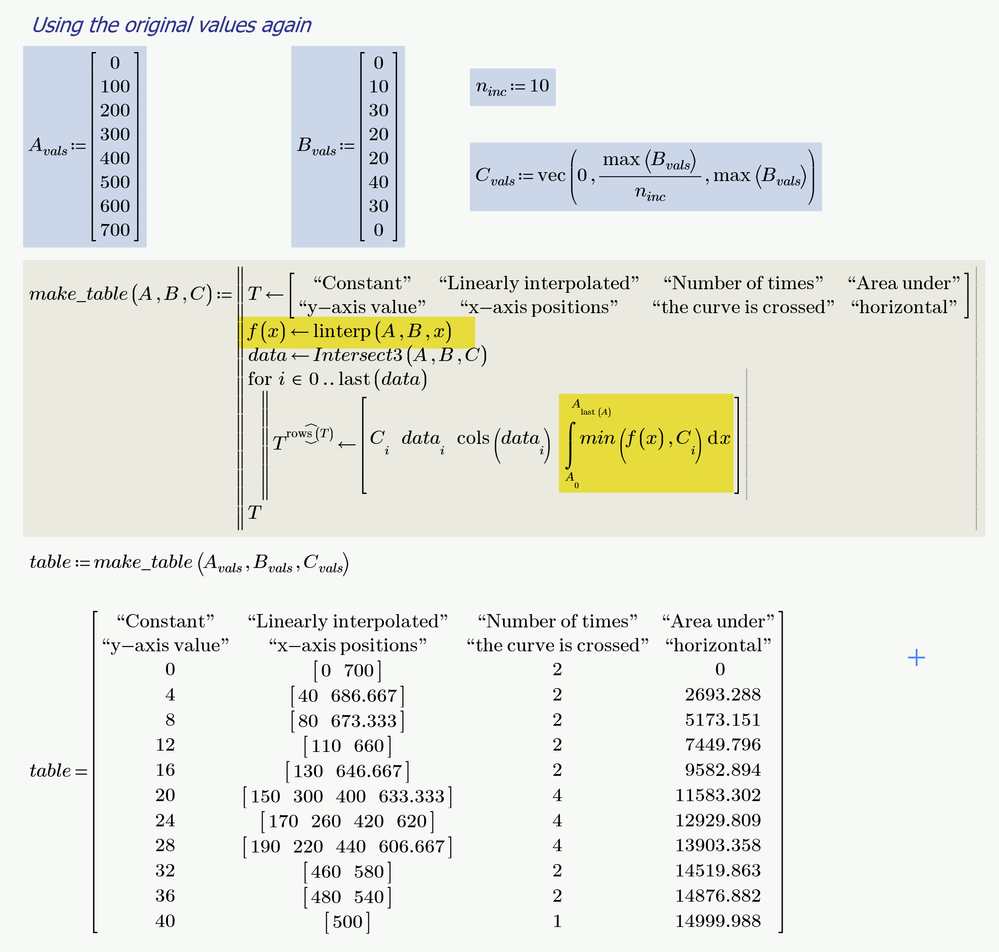

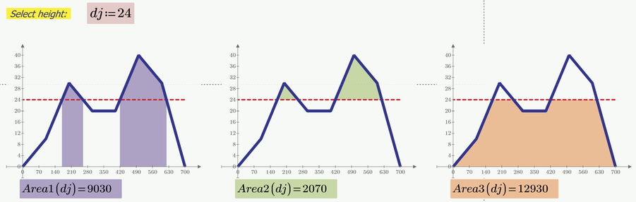

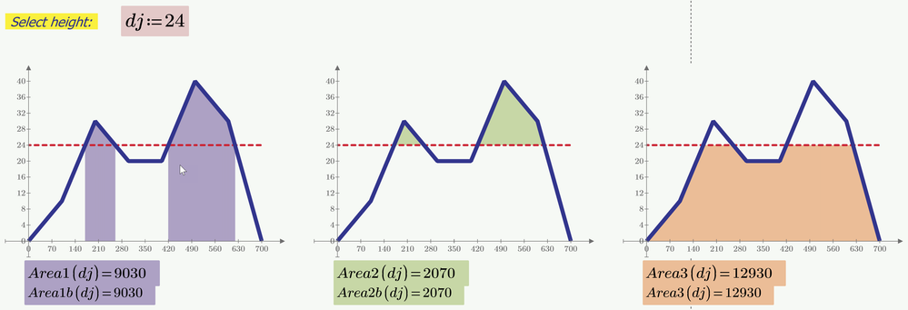

If you have time, would you please add a function to the end of your solution that would determine for each constant y value in Cvals matrix, the area under the discretized curve between y = 0 and y = the constant in the corresponding Cvals row? For example, when a row in Cvals = 24, then the area calculated would be as shaded in purple in the figure posted with this additional request. Obviously I will need to add units to the values. Mostly interested in how to write the loop so that it knows when to use the trapezoidal rule based on the coordinates of the discretized curve and when to use the coordinates that the earlier function interpolated based on intersecting the y = constant lines.
I tried to add units and ran into some difficulty with the NaN values, which I subsequently filtered but it is still a bit of a mess. I'd appreciate any help you can provide in correcting it.

(To:RE_12882698)

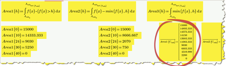

I guess that calculating the area would be easier to accomplish if we DON't remove the duplicate values we get when the horizontal line runs through one of the points defining the polygon.
If we don't remove the duplicates, the algorithm could be
1) Create interpolating function f(x) using "linterp"
2) integral of f(x) from x=0 to x=first x-value in list of intersections.
3) Add area of rectangle from current x-value to next in list, height is C
4) Add Integral from current x to next in list
Repeat step 3 and 4 until x-value = last x-value in vector A.

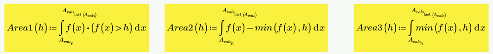

EDIT: No need to use the duplicate values and adding multiple integrals and rectangles!
Define the interpolating function f(x) and simply integrate from first to last value in A the function min(f(x),Cval).
Pls check if the results are correct

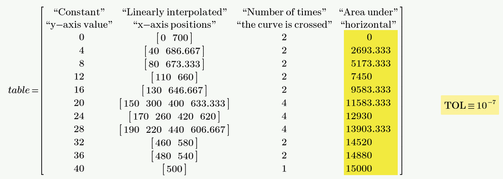

Remark: Te values show numerical round-offs. Last area should be exactly 15000.
Precision can be increased by setting the system variable TOL from its default 10^-3 to a lower value - either in the menu or by assignment in the sheet.

Area calculation cam be quite tricky if horizontals run through a data point.
We would have somehow to distinguish between "horizontal crosses interpolation curve" and "horizontal does not cross (just touch at a peak)".
(To:Werner_E)
Added an Intersect6 function which returns two values in case the horizontal runs through a local maximum  (peak) or minimum, but just one value if it runs through a data point but crosses.
That way it was easy to write functions to calculate the demanded areas.
(To:Werner_E)
Sometimes it helps to sleep on a problem overnight. 😄
And at the morning its easier than you thought!

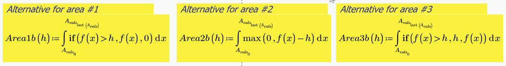

Here are ways to calculate all desired areas without using the 'Intersect6' function introduced earlier (and thus without repeated intersection determination).
And here are alternatives to these functions for your choice
And here an attempt to explain why/how they work
The variants with the if function might be the easiest to grasp.
EDIT: Replaced the somewhat awkward "shade" function by a more generic "hatch" function which can be used to shade/hatch the area between any two curves in a given range of x-values.

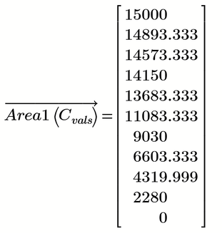

Would you please show me how to write a loop that would produce an array of results corresponding to each "Area1(dj)" result for all values in the dj array (i.e., Cvals)?
(To:RE_12882698)
No loop necessary - use vectorization:
But of course you can create the same result with a programmed for-loop
EDIT: I just noticed that I already had shown how to create the desired array in the file I posted!!???
