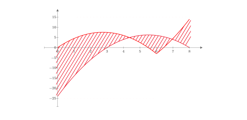

Mathcad Prime 5 displays some really nice 2D plots but is it possible to do something like this? Sort of a hatch for the graph.
Solved! Go to Solution.
I guess the new charts aren't that capable. The best you can get seems to be a solid or a gradient fill, but no hatch.
As in the versions before you'll have to program a hatch yourself.

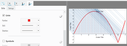

I guess the new charts will look differently as shown in this screenshot if you open the attached file - especially I expect font and arrow size to be much larger unless you are using like me a small, but high resolution screen with a windows zoom (not in Prime) set to something like 250%-300%.
This is due to a bug in the implementation of this chart module - it does not consider the zoom factor set in windows 😞
Another bug is the preview of the new charts. Here is what i see with the chart were I had added the hatch (fortunately the result in the sheet is as it should be):

@DrilonShabani wrote:
This works really nice but the problem is that it is shown in the legend since it's not the same function as the one for the graph. Is there any way we can remove it from the legend?
Again I fear that the chart plot isn't that capable and you can't select which trace you'd like to see in the legend or edit it in some other way. These menu driven plot charts unfortunately are not very flexible and are a big disappointment.
You could give the second plot trace, the hatch, a name consisting of just one blank, but the colored square will still show up in the legend.

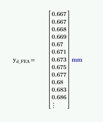

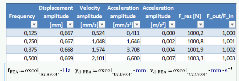

Anyways, I have a simple SDOF oscillator. The vertical displacement has been determined both analytically in Mathcad and by means of FEA. Now I am comparing the results in Mathcad. The FEA results have been imported into Mathcad using the Excel component as follows:
Let us focus on the vertical displacement which I have defined as output yd_FEA. The units are clearly in millimeter. A check of the yd_FEA values in Mathcad yields the following:
...which shows that the units are rightly understood by Mathcad from the embedded Excel file.

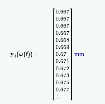

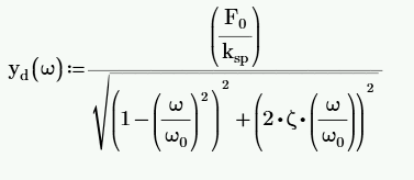

The analytically calculated vertical displacement of the SDOF system has been calculated as follows:
A check of the analytically calculated results for the frequency range in which the FEA was performed yields the following:

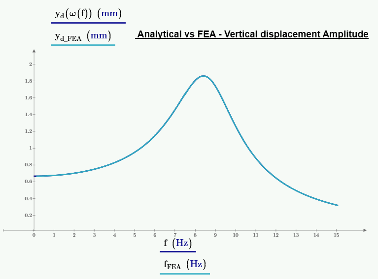

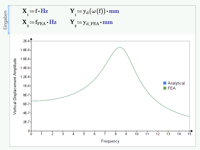

So far so good. The FEA and analytical results both correlate very well and have the unit of mm. Now if I try to plot both values using the Prime 5 chart tool, it doesn't seem to rightly recognize the units of the vertical displacement:
As u see in the chart, even though I have forced the units of the Y values to be in mm, and both results correlate well on the chart, the chart tool gives Y values that are *10^6 off. Only by changing the units to km, does it correlate to the calculate values.
What could be the problem? A bug or am I missing something??? If any one else can figure out what is going on, please let me know.
Btw, if I use the normal diagram option in Mathcad Prime, everything is fine. Only in the chart tool are the units messed up!
In your plot you are multiplying the units with the variable. That gives you a unit squared. Normally you would divide the quantity by the unit you want to show, such that the values along the axes become unitless. Essentailly that is what the 'old' 2D plot of prime does, when you put the unit between brackets: it divides the quantity by that unit to get the values along the axes.
So instead of Y1:= yd(...) * mm, you should: Y1:= yd(...) / mm.
Works like magic. My bad then. Would have been shocked if it was a bug with the chart tool. I just got too used to multiplying to get the right units that I missed the aspect of dividing by the unit to get the right values when dealing with variables

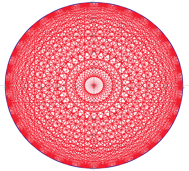

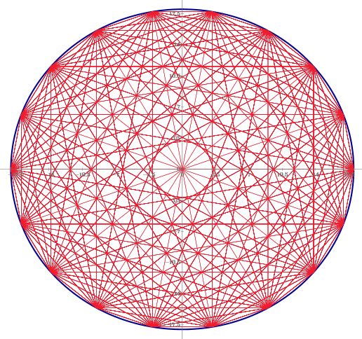

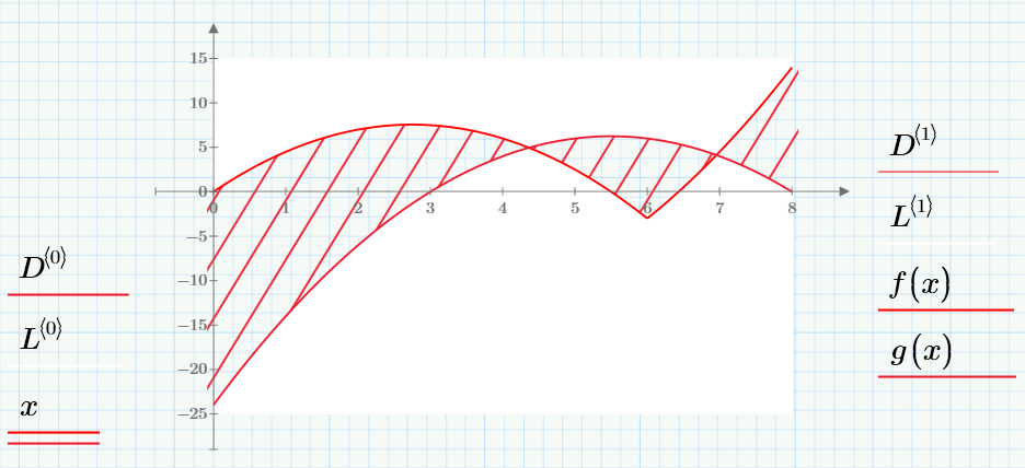

Using Hatch function by Werner_E Level 20 , (Inclined hatch) T.Tokoro.
Inclined hatch
Can you show the angled hatch with a transparent background? 😉
Angled hatch area is with a transparent background but other areas are fully filled by lines.
Therefore, the cross points of the functions are not solved (used).

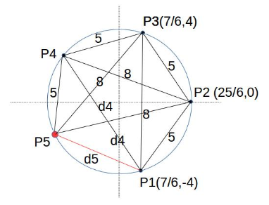

Pytagoreanth Puzzle.
There is a circle with center (0,0) and radius r.
Find 5 points P1 to P5 on the circle and P3 is set at (r,0).
All distances of any two points are Integer.
Find the smallest r and the positions of all 5 points.
How about 10 points of this probrem.
Yuo can use Mathcad of course.
T.Tokoro

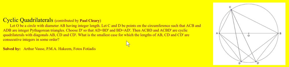

Hmmm, interesting puzzle!
Reminds me on "Cyclic Qudrilaterals" here -> http://www.contestcen.com/geom.htm
Yes, that was my point - my asking was a little bit nasty 😉
It took me a while thinking about how you achieved the nice, angled hatch effect with your two hatch functions until I realized that you are hatching a rectangle first and then you hatch-paint the "outside" white.
Clever idea nonetheless.

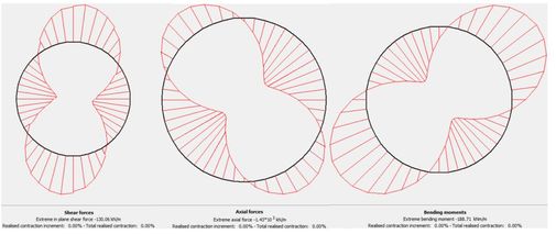

Does anybody have an example "Hatch" function that creates a hatch between two functions plotted in polar coordinates?
Can you post an example of what you are looking for?
It doesn't necessarily need to be in polar coordinates, but I was thinking that might be a convenient form if possible.
An example of what I'm attempting to recreate is attached. The example is showing forces distribution acting on a circular body. I'm starting with the x,y coordinates for the nodes along the circle and corresponding force/moments acting on each point.
So post your worksheet with the plots (without the hatch).
This would also show which version of Mathcad or Prime you are using.
