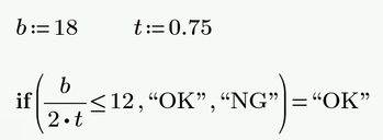

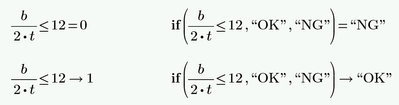

I'm trying to check the flange thickness ratio, b/2t, with b=18 and t=0.75. Therefore b/2t=12. 18/(2*0.75)≤12 returns true, of course, but b/2t≤12 returns false. This does not happen with most other values of b and t. What's going on here and is there any way for me to fix it?

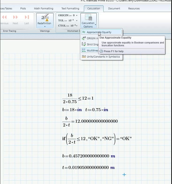

The situation is reproduceable if units of "in" are applied to the dimensions.
The solution is to set the calculation option to approximately equal
Cheers
Terry

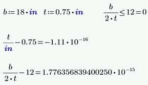

Prime is not able to show as many decimals as would be necessary.
But you can let Prime display the difference from the desired and expected value to see the problem.
Turning on "Approximate Equality" gives you no control over the range within values are to be considered equal, but its sure convenient and most of the time sufficient.
Prime chooses an approach where the percentage difference to the value to be compared is decisive. This percentage of value approach may be appropriate in many cases, but I could think of cases where an absolute value is more desirable.
BTW, symbolic evaluation does not suffer from this (independent from the "Appoiximate Equality" setting:
