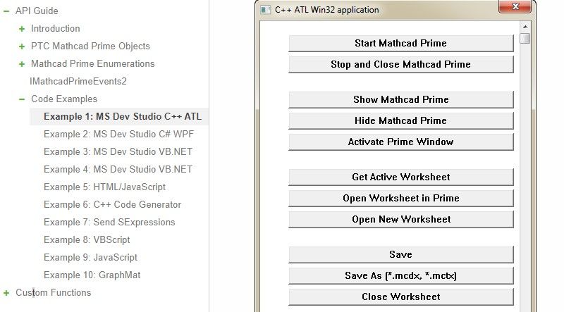

I suggest starting with the help file which has an example in C++
I guess that does not answer the question of the OP. Unless the examples contain the use of OUTFILE in working order.

I can confirm that I do not wish to make a Win32 program using the Mathcad Prime Application Programming Interface.
Instead, I want to make a DLL in C for Mathcad Prime 9, like the documentation says I can, like I have in fact performed.
I compiled and ran the test examples given for command line compilation using MS CL compiler.
I also got the process to run in VS Code with CMake and all that.
But what I want is the INFILE / OUTFILE arguments per the Prime 9 C header file MCADINCL.H to work -> and I have tried stuff there with no success.
