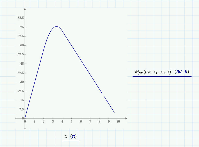

I'm trying to make a spreadsheet that graphs partial uniform loads and seem to have run into an issue. It all works for the most part. However, when trying to graph, the graph typically "fails" in certain places. See my attached file and notice the missing portion of the graph at x=8.4ft.
Is there any way to fix this?
Note that I've already tried messing with the TOL global variable to no avail. It usually causes the break to move to a different place in the graph and doesn't actually fix anything. If it does fix it then it is usually just for that one case and if you put in different loads/locations it'll break again. What should I do?

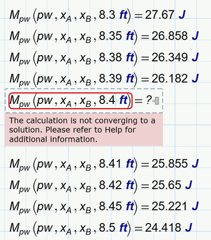

I opened your sheet with Prime 6 and can confirm that the function returns an error for x=8.4 ft and that changing the TOL value does not solve the problem.
Slightly changing the value of x.A (to 2.0001 ft) "solved" the problem.

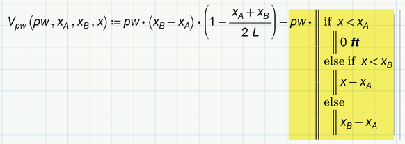

Here is a more efficient way by defining function V without an integral:
Calculation now is lightning fast, the results are more precise even without using a smaller TOL value and the problem with x=8.4 ft is also gone away -> win-win-win 🙂
Of course you could also use the if-function
or the program if
if you feel thats better readable. All three version are fast, provide better precision and do not suffer from the 8,4 ft problem.

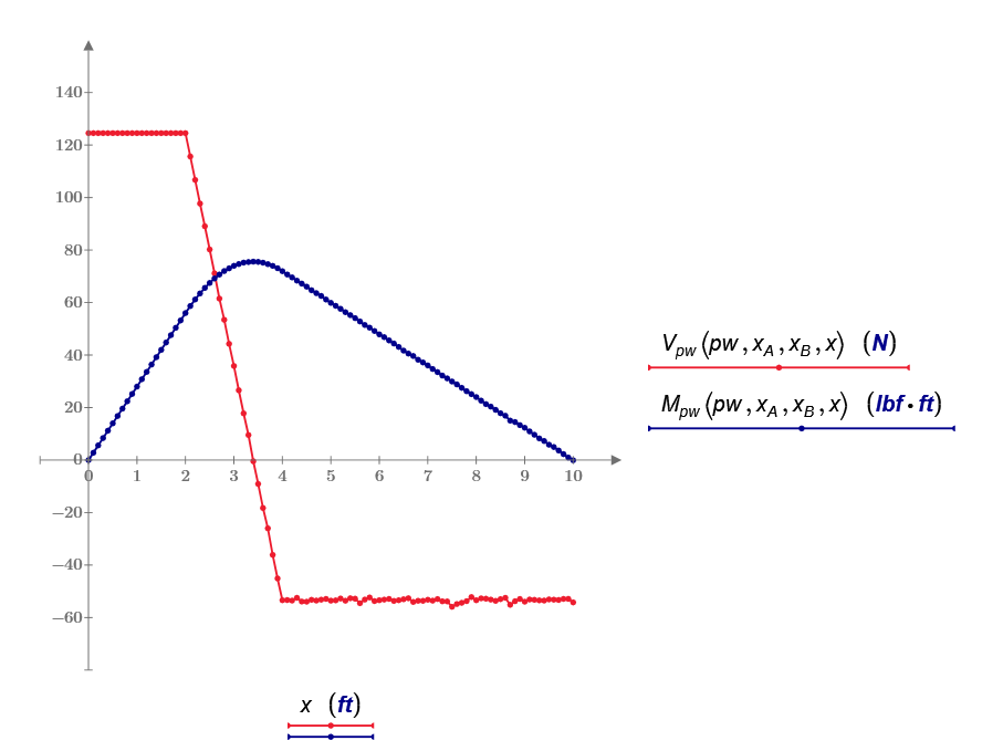

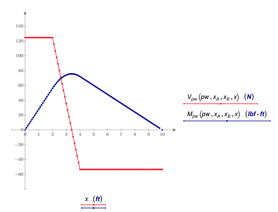

In version 7.0, everything is displayed normally on the plot:

Prime7 TOL=10^-3
TOL=10^-1

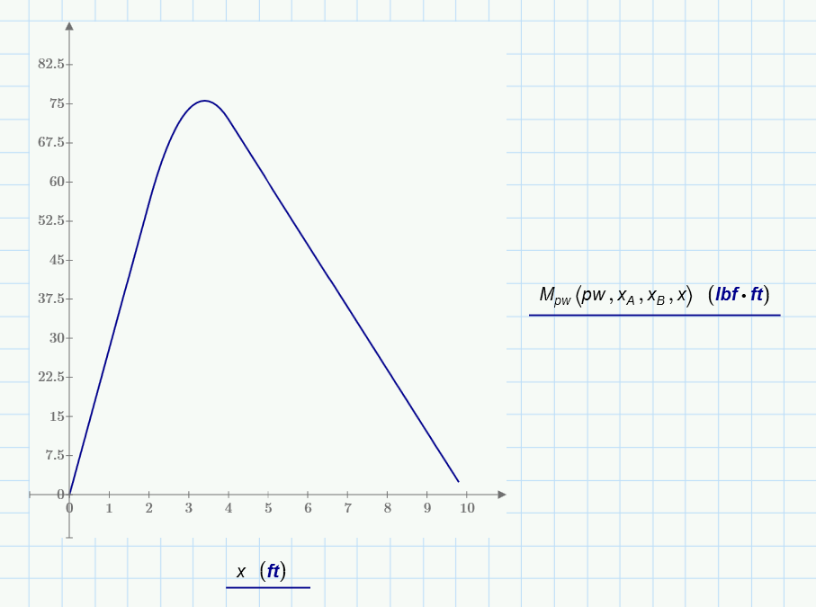

I’m on version 3. I guess that’s why. It’s just weird that the whole graph would work fine except one number.
Tested in Mathcad Prime 3, result (in both cases, I did not change the calculation tolerance, just recalculated the entire worksheet):
