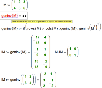

How can we calculate RIM?

Personally I would prefer Stuarts way, but if you feel so, you may also use "geninv" to get the desired result:
The calculation which is done behind the scenes when using the above shown way with "geninv" is actually this:
