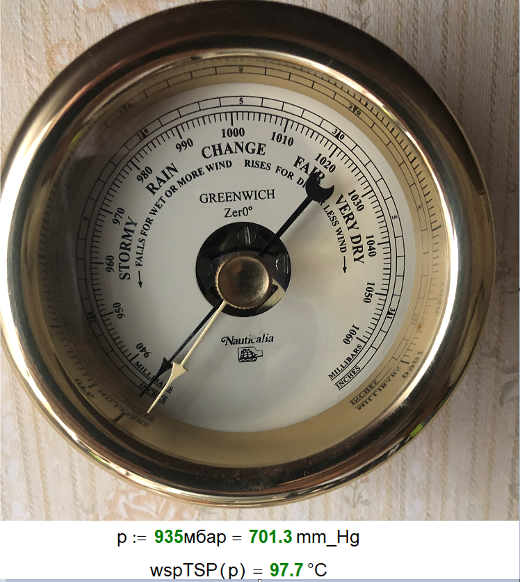

My English barometer, bought all the way in Greenwich, Mathcad and WaterSteamPro show that in Moscow water is now boiling at a temperature 2.3 degrees lower than at normal pressure. So eggs, soup, pasta, etc. need to be cooked longer!

Are you sure the barometer indicates the correct air pressure?
It's either that, or the arrow is at its rest and can't indicate any lower value.

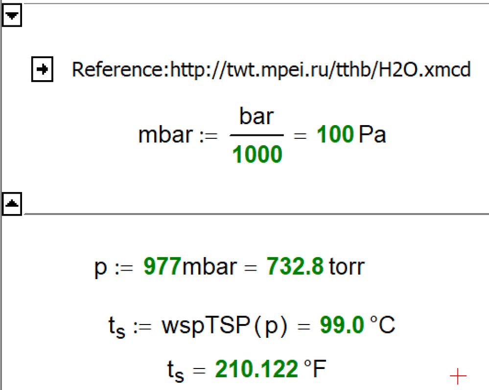

Now (21:48 not 8:00) the arrow points 950 mbar.
All ok with my barometer. With wether is not OK.
Today eggs can be boiled not so long
