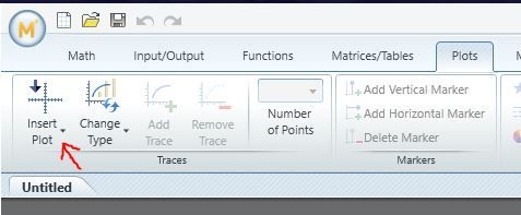

There are two ways to plot in Prime.
a) Plots | Traces | Insert Plot -> This gives you the plot type used.
b) Math | Regions | Chart Component -> This gives a more adjustable plot.
The chart component when you double click it brings up the edit window of the plot.
In edit window you can change number of ticks, add labels, add legends etc
I have added a chart component in the file to show you.
Cheers
Terry
