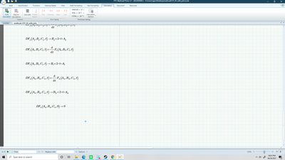

I'm trying to take the derivative of a function with respect to t but it shows as 0 when it is not. could you please help?

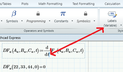

You've been hit by Prime's infamous autolabelling feature.
The t in the d/dt is labelled an automatic (variable):

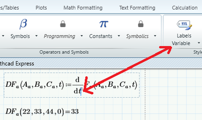

instead of a real variable:
So change its label to variable and all should be as expected.
