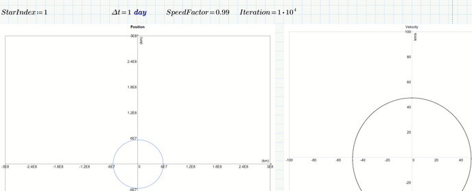

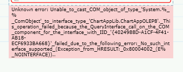

When I change the Delta_t from 3 days  to 1 day, it recalculates and gives an error message on the plots for position and velocity below
The error message is:
You've used the chart component, which is the probable cause for this error. The chart component is a third party component that is badly integrated into Prime. While it allows to set a grid, it does not handle units, which to my opinion is a no-go. You're using no grid, so in the attached copy, I've changed the chart components to native plots. (There are ways to plot a grid into native plots, see e.g. https://community.ptc.com/t5/Mathcad/Bode-Plot-NaN-Complex-values-Error-and-Plot-Grid-Does-Not-Exist/m-p/830506/highlight/true#M203237 )

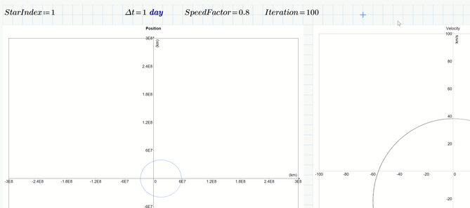

I've not experienced sudden crash of Prime at the combination of the following settings:
(To:LucMeekes)
When I change Delta_t to 1 day I don't get any error or crash.
The same applies when I set the values of the other variables to the one you named.
