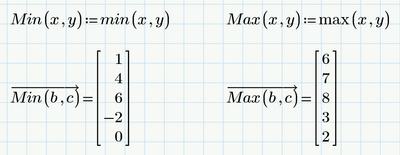

I am trying to find the min/max value at each index across 2 matricies.
The min/max function finds the smallest/largest value across both matricies at every index, which is not what i want.. PNG and mathcadfile attached for clarity. I am using mathcad prime 9.0.0.0. I have tried several syntaxes (shown in the attachment), but to no luck.
Does anyone know the syntax for this?

The built-in function "min" and "max" can't be vectorized, but you can define your own Min/Max functions based on the built-in ones and call these vectorized:

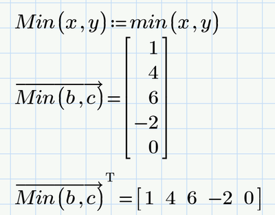

Is there an easy function or setting to make the answer come out as a 5x1 matrix, rather than a 1x5?
January 11, 2024
The answer actually IS a 5 x 1 matrix (5 rows, 1 column).
If you would rather like to see it as a row vector (1 x 5 matrix), simply use the Transpose operator.
