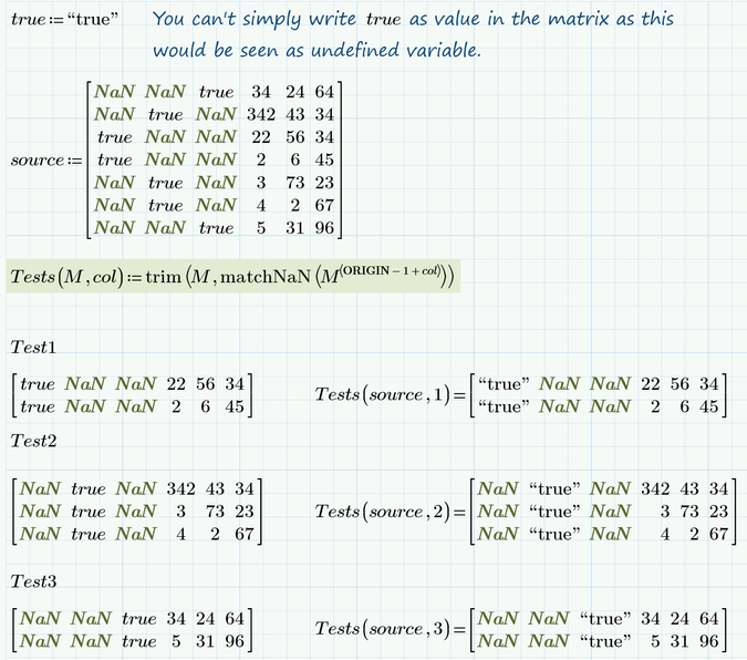

I have a matrix with test results from different kinds of tests (500 x 1000 in size).
In the first 5 columns it tells which tests are done by either a true statement or nothing.
For calculation I want to select specific parameters from specific columns that are only done for a specific test.
To do that I think I need to filter make a new matrix where I only select all rows where a test is true. After that I can select the right colums for the parameters.
I am afraid I cannot share my original file but I made a small example of what I am trying to achieve
In the first matrix the first 3 columns represent the output if a certain test has been done. columns 4 to 6 represent the test outcomes I want to use for my calcylations. The 3 matrixes below are the desired output.
I hope someone can help me with this.

Couple of comments.
You can use the READEXCEL command, if the source file is an Excel file.  The READEXCEL has an option to to set blank cells to NaN, number, or a string.
The if, match, etc. can be used with strings.
The match command list the indexes for each match.  The indexes can be used to sort on columns to select the rows of interest.
Cheers

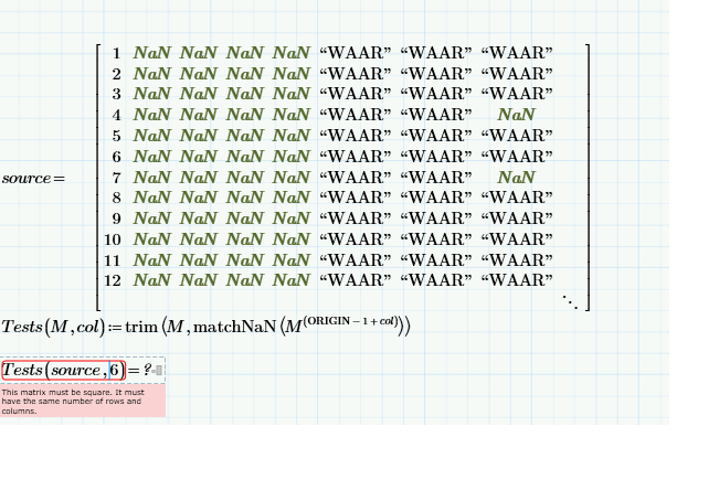

Thanks Luc for the file and Werner too for your suggestion. I however still encounter some issues.
About Luc's solution:
I tried loading in my Excel with readexcel after setting the string WAAR := -1.
Now I get an error on the select options. See the atached image below.
The error boxes state the following error: Unknown error: col_must_have_uniform_dimension_or_all_strings.
I think thats because the true in the example should have been "true"
ErrorError

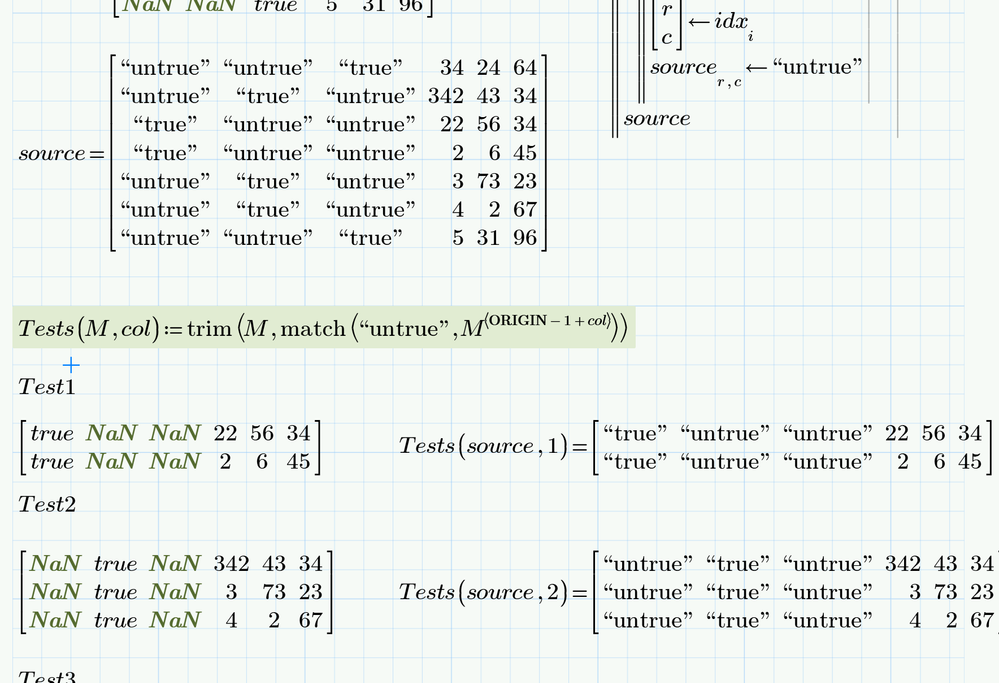

Now a colegue of mine has changed the values in the fields of the tests to true and untrue (instead of NaN).
How do i change the formula?
(To:GvanBoven)
@GvanBoven wrote:
Yes I noticed it. Thanks anyway for pointing it out.
Hopefully its text, that is "untrue" (with the quotes.
In this case you write "match" instead of "matchNaN" and in the function parenthesis you add "untrue" as first argument.
(To:GvanBoven)
This should do the job.
Don't have P31 installed an PTC software is silly enough not to be able in older formats, so all you get is a picture:

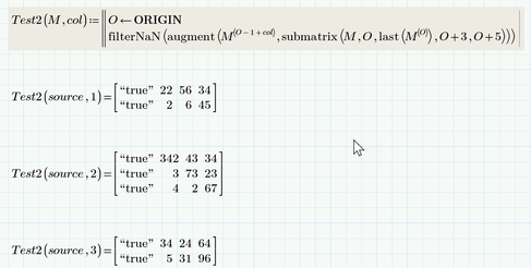

While "Match" or the various "Lookup" functions often provide reason for complaint, I am not aware that "filterNaN" would do so, too. But filterNaN would not be very useful for your problem, as it would remove every row in your matrix which contains one or more NaN's, which in your case would mean it will remove every row leaving nothing which again would result in an error.
You may user "filterNaN" if you want to omit the test columns not in question from your output, though:
