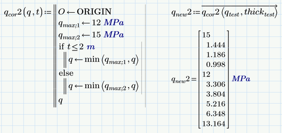

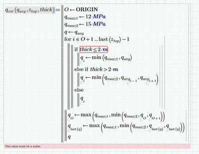

I need to choose the minimum value of q depending on the layer thickness...
If the layer thickness is =< 2m the q should be the minimum value of ( q;avg or 12MPa)
if the layer thickness is > 2m q should be the minimum value of ( q;avg or 15MPa)
I tried to do it this way, but it is not working.
Can you spot the mistake in this , please?
Thanks in advance
Yusra
Prime 9 page 12
(To:YA_10963798)

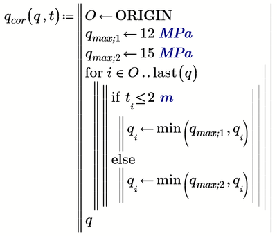

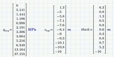

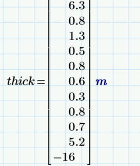

The vector q.avg which you obviously want to modify contains 12 elements.
But the vector thickness contains only 11 elements.
So its not clear which thickness should be assigned to the elements of q.avg.
I also wonder about the last entry (-16) in vector thick ...
I also don't understand your second min usage with three inputs and also not your last max/min combinations. They do not correspond to what you have explained in your text.

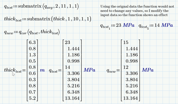

So just looking at what you have written that you need, it looks to me that q.avg and thick should be of the same length and that each entry in thick correspond to an entry in q.avg. And if the corresponding thick value to an q.avg value is smaller or larger than 2 m, different upper limits for q are used.
If thats true, you have to provide two vectors of equal length and the following function should do its job.
For example
Personally I would prefer to write the function just for scalars and then call it vectorized
but that may be subject of personal tast.

Just one question about ( min function) why it works only with scalars ... whenever I want to use it with vectors or matrics  it doesn't work ...
How to overcome this ?
Should I always use programming ?
For example the following program : in each (qc;gem;cor ) I have 3 matrics each one has ten values.... what I need is to write a program that will compare the both variables and choose the minimum value of each one ( compare the first raw with the first raw  and chooses the min ...and so on  ) ...and the result should be also one matric with ten values. However, it chooses only the minimum value of each matrics
How can I do this ?
(To:YA_10963798)
The "min" function works that way because PTC had chosen to implement it that way. When you feed this function with a couple of scalars, vectors and/or matrices, it will return the overall minimum value of all of them. The same is true for other functions like "max" or "mean". Usually this isn't bad and is exactly what the user wants.
And yes, if you want something different, you have to do a little work on your own to achieve the desired effect.

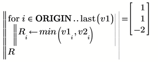

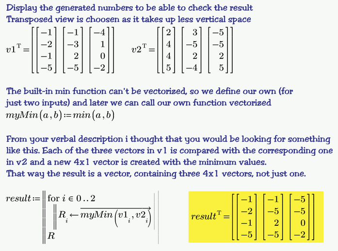

Lets say you have to vectors v1 and v2 of the same length and want to create a vector similar in size containing the min value of each 'row'.
There are various ways to achieve this result.
What comes to mind is that we could use the built-in "min" function, but as you already know, this function would just return the overall minimum of all provided values:
Next idea could be to vectorize this function call. After all this is exactly what vectorization is made for. Unfortunately there are a few function where vectorization has no effect and "min" is one of them
So one possible workaround could be that we define our own minimum function for two inputs because this function now could be called vectorized:
Bingo!
Another way, as you wrote yourself, is programming. Looping through the vectors and choosing the minimum in each turn
And yes, there sure may be even other ways to skin this cat.

Here is what I understood so far from your verbal explanation. The first part not seen in he picture is just the creation of the sample data. You can see it in the attached P9 worksheet.

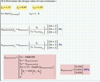

Actually what I need is something different I need the program to compare qc;gem;1 and qc;gem;2 and choose the minimum between both of them.
So , it goes to the first raw in both variables and choose the min and then goes to the second one and does the same.
but what we did is just choose the min value in each matric
(To:YA_10963798)
So post what this would mean in context with the example with the two nested vector v1 and v2 I posted.
If my guess wasn't what you intended - what should be the result for them?
EDIT: Upon having a second look at your sheet and zooming in, it may be that you need to apply vector indices!
Can't be sure, though, as I still don't down what exactly you are looking for.
BTW, its better to use "last" instead of "length", because "length" will only work OK as long as you have set ORIGIN to 1 as in your sheet.

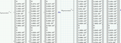

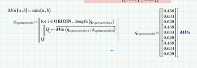

I tried this function again , but I don't know why it shows all of the results equal to zero .. I'm pretty sure that zero is not always the min value. Do you know why?
These are the two values which i'm comparing
(To:YA_10963798)

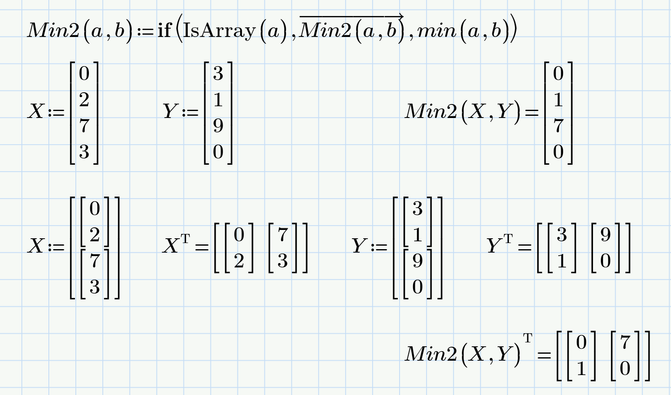

The data structure of the two q vectors looks unusual judged from your second picture.
It seems that its multiple times nested.
This new question nicely demonstrates what I had already stressed multiple times and what Stuart also addressed in his answer above (here). Creating a small demo sheet using with the function you use with similarly nested data would have been highly beneficial. Especially compared to just a picture where we only can guess what the data structure actually is.
The program you use would work fine if each of the two q vectors consists of a couple (maybe three) normal vectors.
But the elements of your q vectors seems to be nested as well and this may be the reason of the unexpected results.
Here a simplified example which should demonstrate the difference:
If you really need to keep this heavily nested data structure intact, you may try this modified Min2 function. Vectorization is done within this function so you don't have to use vectorization when calling it.
I guess you can use this function directly with your two q vectors as arguments and so can omit the for loop altogether. Give it a try.
