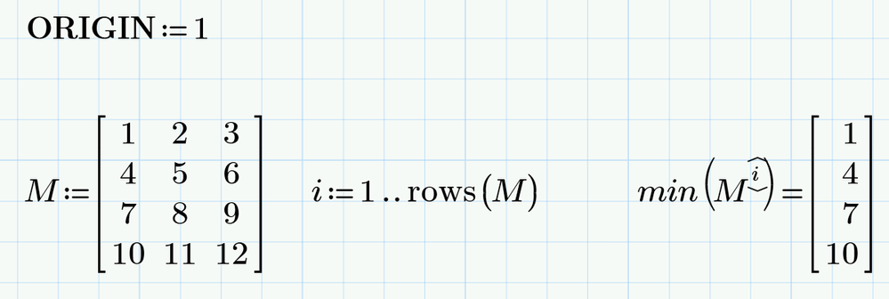

 Hi everybody,
I'm try to learn more about this software so my questions maybe are a bit basic. Is there any simple way to extract the minimun values of a arrays of a matrix a generate another matrix 1xn ?. Something like this:
The problem is that the size of the matrix wil change in each exercise.
Thank you in advance.

One possibility is as follows:
Alan
More simple (not in Mathcad 15 - only Prime)
(To:beginner)
Here is basically the same which Alan had suggested, but using Primes matrix row operator and turned into an ORIGIN-independent utility function:

Thank you for your clear and quickly answer. It is very usefull.
