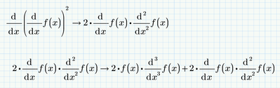

Thats really bad! This bug is already present in earlier Prime versions, too. I tried in P4 and P6 and there is no difference whether  the new symbolic engine (FriCAS) or the legacy engine (muPad) is used (apart from the legacy engine being much faster).
Older versions deliver a nicer display as they omit unnecessary parenthesis, but internally after copying the first symbolic result, the explicit (!) multiplications are ignored as well. Quite a bad bug.

It was also my first idea that it may having something to do with implicit multiplication but then I noticed that Prime correctly puts explicit multiplications in between the expressions, so there should be no doubt that the second derivative in the result is NOT part of the argument of the first one (which is how Prime treats it after copying).
While I generally agree with you that the result should be assigned a function or even just a variable and not being copied, copying should not result in such a wrong outcome.

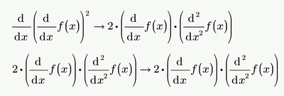

The problem remains in Prime 9 but is fixed in Prime 10 and later.
But only because the symbolic result is displayed differently grouped
If we manually input the expression without the parentheses, we still get the wrong looking result
The parentheses around the derivatives look ugly and should not be necessary.
The product in the last example should only be interpreted as the expression to be derived if its put into parentheses, otherwise the evaluation looks wrong for a reader.
