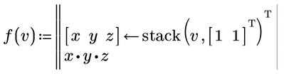

Its not an equation what you are talking about but rather a function!
Unfortunately user-defined functions in Prime are not allowed to have a variable number of arguments/optional arguments.
Usual way around this restriction is to write a function with just one argument which is a vector. The function can then determine the number of elements in this vector and can act accordingly.
In your example y and z default both to 1 if no argument is given, so you could use
It would be slightly more work if the default values for y and would not be the same.

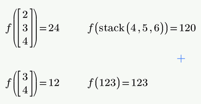

You can use this function now that way:
Of course your specific example could also be written using the product operator
