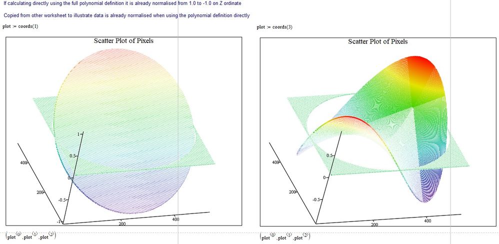

Have included a worksheet that shows the difference between:-
a) calculating by formulas Zj(rho,theta) that needs a Normalization constant, and
b) calculating using the direct polynomial definition Znm(rho,theta) that does not need the Normalization constant.
The Normalization worksheet shows the difference between a) and b)
I have made some alterations to the original file that stops recreation of the "file" matrix when you change the plot above.
Cheers
Terry

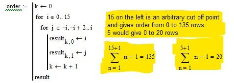

Taken a while to answer but the enclosed worksheet will help.
Cheers
Terry

If you set the 3D plot to the following setting you get a plan view of disk in exact orientation as the Wikipedia disks.

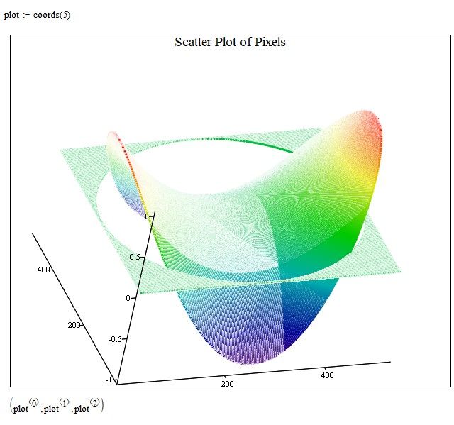

I have a question regarding the 517 x 517 pixel square and Zernike polynomials defined on the unit circle.  Before I blast away and show you how to file the 517x517 pixel grid.
Zernike Polynomial radial function is only applicable to radius "rho" from 0.0 to 1.0. The unit circle. In the case of a square 517 x 517 grid your calculations have a "rho" in the corners and adjacent areas of up to 1.414 being the diagonal (radius) of the unit square. Do you want to do this or do you want a conformal mapping square to unit circle with "rho" <= 1.0? Below describes one such mapping.   Doing some research to get a reversable method of mapping square to circle.
Have plotted them so you see what I mean.
Cheers
Terry

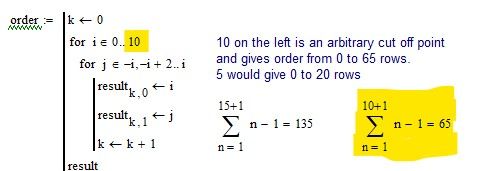

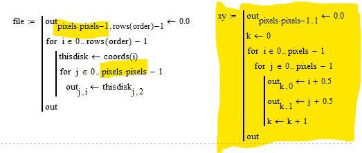

Done!
Now coordinates are by pixel and values outside the focus are zero.
Warning the resulting "file" matrix is large.  I have 128 GB of ram so can have really large matrices.
If you have problems reduce the maximum order of polynomials
Cheers
Terry
Prime only plot 40000 points for each color of plot points.

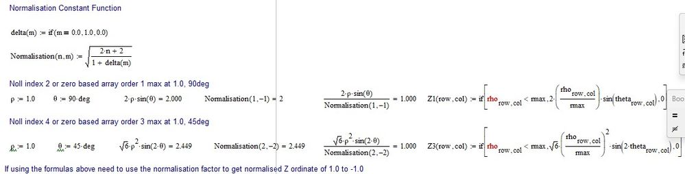

Thanks for the new script!  I ran the script and, from what I can determine, it does evaluate the user selected # of Zernike polynomials and then "flattens" each evaluated Zernike polynomial into a data vector and joins each of these data vectors to create a single array.  It is then straight forward to perform some matrix algebra with the data to perform the fitting.  One additional thing I forgot to mention and appears in the original file I sent for each individual Zernike polynomial is a normalization constant.  The definition of the Normalization constant for Zernike polynomials is
Nn,m = sqrt((2n+2)/(1+delta)), where delta = 1 for m = 0 and delta = 0 for m not equal to zero.
In looking at your script it would appear that I could define this normalization constant after the definition of the radial polynomial and then combine this with your definition of the full Zernike polynomial. Not sure how to enter the logic You might have a better suggestion.  thanks.
Cheers
Terry

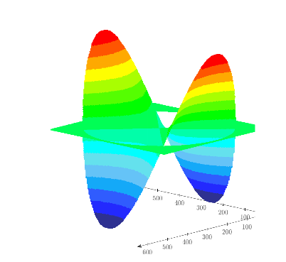

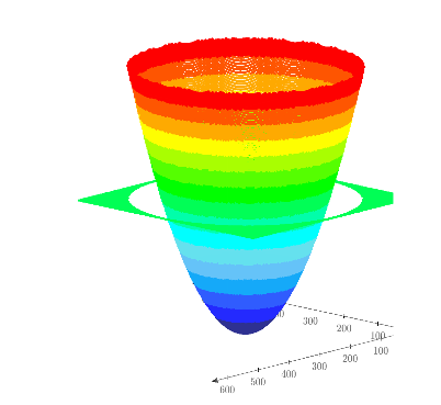

Not that I know what I'm doing here (unlike Terry), but this looked like it could be fun! So, perhaps the attached might be of some use.
I get the following images, which are similar to those on Wikipedia, though rotated:
