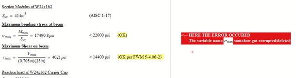

Find attached a repaired version which loads in Mathcad 15.
As far as I found out a variable name on page 30 got corrupted/deleted
But it looks like thats not all. On page 33 I see the following which sure isn't as it should be:
So you will have to check the file (at least beginning from page 30) for missing or wrong regions.

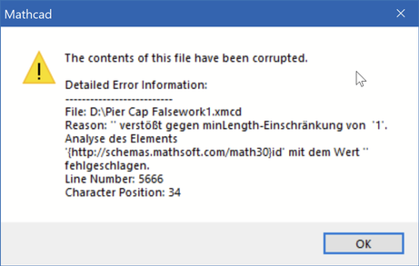

As Luc sure has more experience I attach the error message we get when we open the original file in MC15. Maybe he is able to find a better way to repair the file:

I guess Werner, you found the spot of THE error.
Regarding R.d, I don't see a definition of it, prior to its evaluation. I also don't see an R.d in the drawing next to where R.a, b and c are defined. Maybe it wasn't meant to be in the file at all.
(To:LucMeekes)
Given the error message stating the location of the error there was not much searching necessary 😉
I guess @jomok25  did not know what you mean when you asked him to give the error message with line/location indication.

Error line 456 col 173
