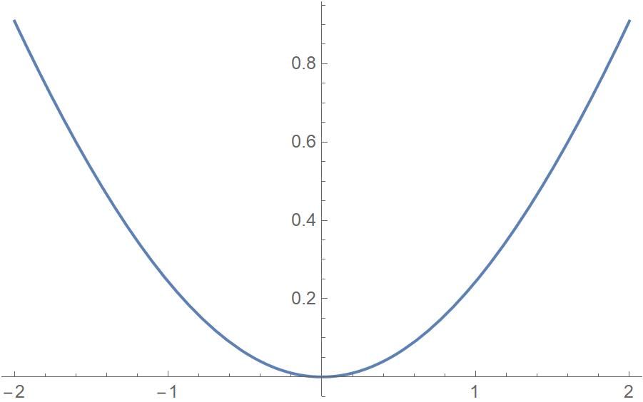

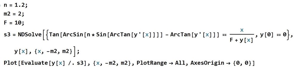

Val sends his thanks to all, and notes that he has solved the problem using Mathematica:

Hi Valery,
The highest derivative of the sought function must be on the LHS of the equation.
Reason: Odesolve uses the/an RK4 algorithm, where the (highest derivative of the) sought function must be expressed as an explicit definition.
(To:AlanStevens)
According to the help "The ODE must be linear in their highest derivative term" which is not the case when the derivative is used as argument of arctan.
