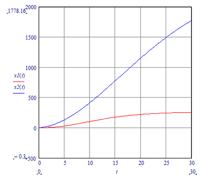

The solution to your set of ODE is (approximately):
Gives:
