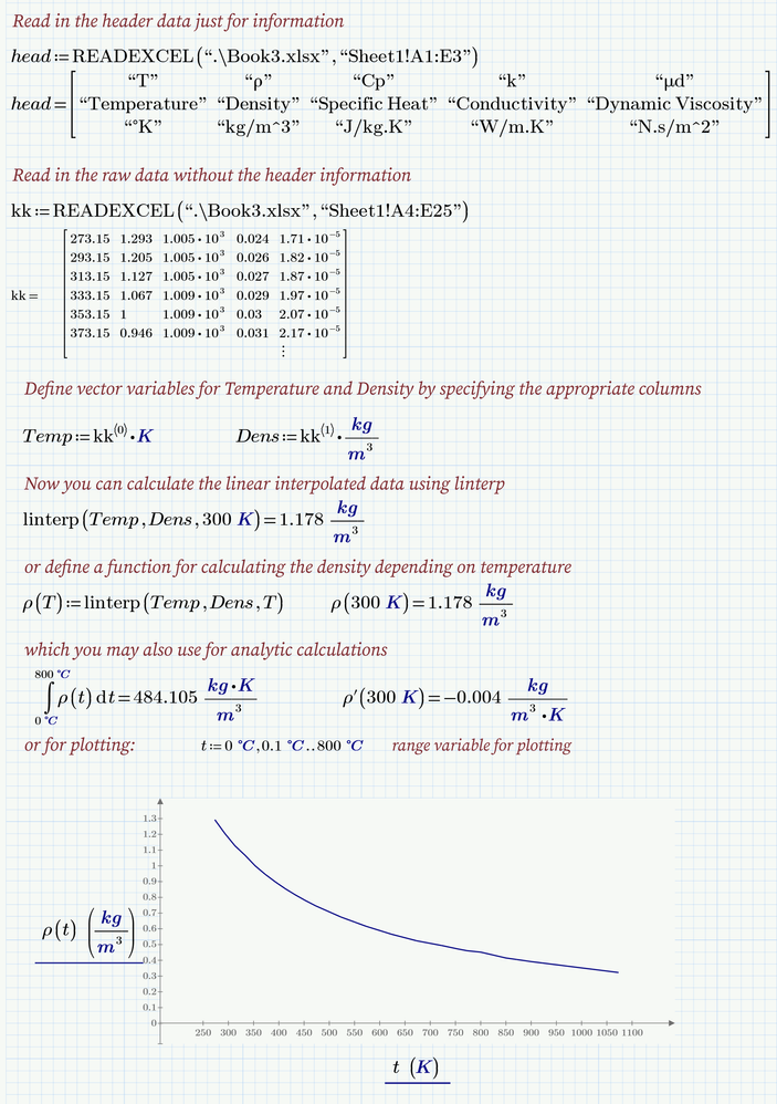

Also, can you please help me with how to do interpolation from excel sheet in mathcad prime
  1. The table is imported from excel into the Mathcad, and interpolation is to be done in Mathcad.
  2. The table is in excel; Mathcad is reading the data from excel and does the interpolation without bringing the whole table in Mathcad.
I am unable to figure out this so needs to understand how it is done
(To:SP_9781969)
Here is one way to do it:
Instead of reading in the fill table and extracting the appropriate columns you may also just read in the necessary data only, like this:
I would advise to add and use units as far as possible.
P6 sheet attached
