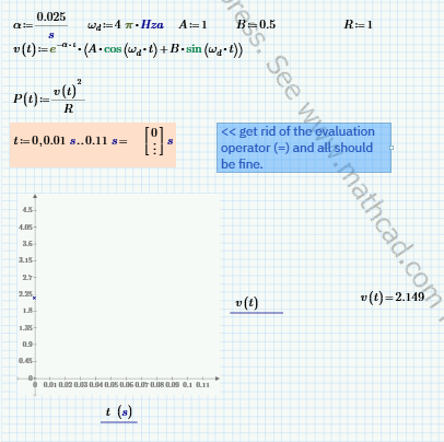

Heya, I've been looking everywhere, I've been following basic plotting tutorials, but I cannot for the life of me find a way to plot my function. Each time I try I just get a single point on the y-axis. Any help would be incredibly appreciated.

If you put an evaluation operator at the end of a definition involving a range variable, Mathcad has a (nasty/useful) trick of converting the range to a vector.   There are some who find this a useful thing as a means of creating vectors.  I generally avoid the practice like the plague as it can catch even the experienced out and, apart from vectors, the output can bear little resemblance to what's stored in the defined variable.

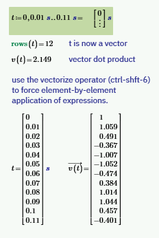

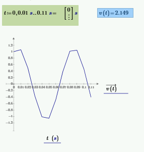

Forgot to add ...
The reason you are seeing a single point is that squaring a vector returns its dot product (single value).  If you want to use vectors, it's generally a good idea to check the numeric values and use the vectorize operator to apply functions/expressions to each element of a vector (or matrix).
Stuart

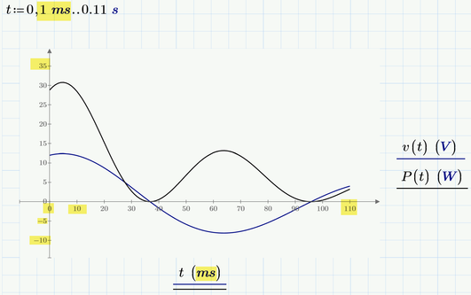

BTW, you sure want a range variable with a smaller step width and you also may consider manually changing the axis values as Primes automatic usually does a quite bad job here.
You can edit the first, second and last value on each axis
Thanks for the tip, you're right, ms does seem to be the better choice, and decreasing the step makes a huge difference.
