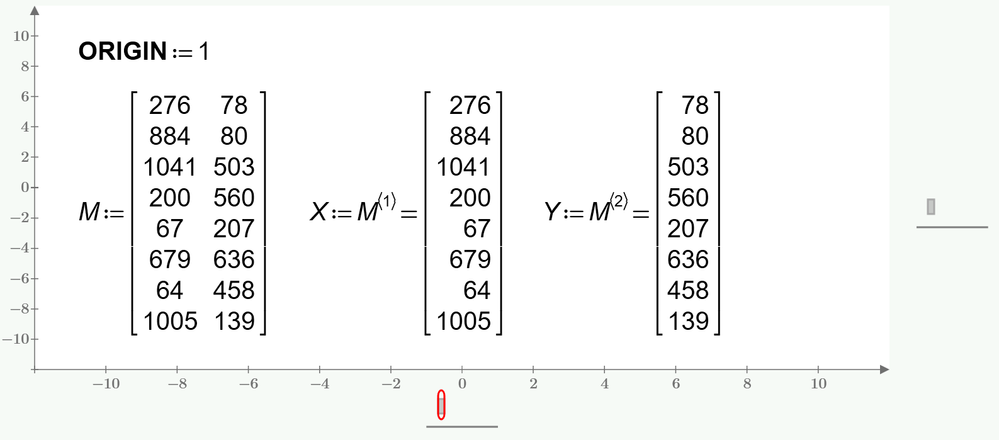

I prepare my Mathcad figures for publication so that they are on a white background, not on a paper background. One of the solutions is to move the operator to the plot area with a white background.
Are there any other solutions?

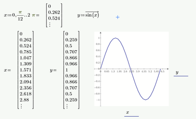

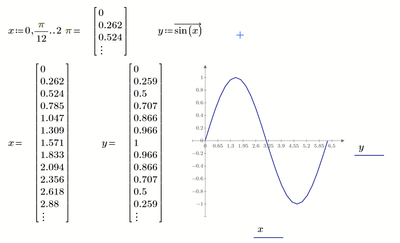

Using the appropriate software you can exchange the background paper color for plain white after taking the screen shot.
You may use a full blown picture editing software like Photoshop, Gimp, etc. but even the simple Editor of the Screenshot software SnagIt offers a way to do that.
BEFORE:
AFTER:
