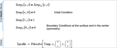

I am trying to solve a simple PDE which I solved in MathCad 15. I am struggling with Prime 7. Please help. Thank you very much.

I don't think that pdesolve is implemented in Prime.

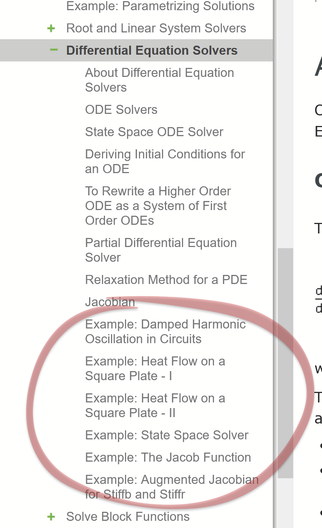

Maybe you can use one of the commandline solver for PDEs
https://support.ptc.com/help/mathcad/r6.0/en/index.html#page/PTC_Mathcad_Help%2Fabout_differential_equation_solvers.html%23

Have you looked up the examples in the Prime Help?
You may also look at the examples in the MC15 help which IMHO is a much more user friendly system. E.g. the quicksheet about the Wave Equation, where the solution derived with pdesolve is compared with the one derived with numol.
Pdesolve is not supported in Mathcad Prime 7.
