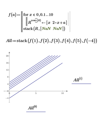

I don't think this is possible, but hope dies last, so hence this post:
Is it possible to plot multiple traces in Mathcad Prime with the arguments being sourced form a single matrix or array?
Let's say I have a simple function of the form f(x): 2x + a
I have an array of 'a' values: a: [1, 2, 3, 4, 5]
I wish to plot 5 traces (a trace for each value in 'a') without manually adding and writing out the function five times in the plot window (there will be cases when I might need to plot many more than 5 traces, so looking for efficient methods).
Your responses would be greatly appreciated.
3 REPLIES 3
Nevermind, found this:
https://community.ptc.com/t5/PTC-Mathcad/Multiple-Variable-Functions-and-Plotting-New-Critical-Limitation/m-p/73601/highlight/true#M29260
Seems there's not a simple way, but it is possible via a program.
From this forum.
