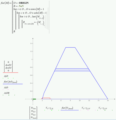

I just use Mathcad prime 8. I've got an issue where trying to plot in the graph and then get a notification (there are too many range variables) as shown in the snapshot below. Could you please help how to solve this issue.

OK, the attached files are what I would call a stripped down sheet still showing the problem.

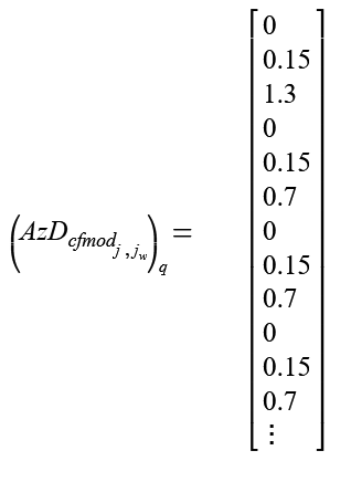

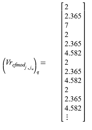

I often have to do Prime bashing here simply because Prime is so mediocre. But in this case Prime is pretty innocent. It's the fault of the author of the MC15 sheet, who made these terrible graphics. It is a paragon of all wrong and cruel abuse of ranges - really bad! In fact, one has to blame MC15 for accepting this.

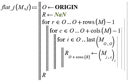

Here's a little function that turns the nested matrices used in the graph into the apparently desired linear list of values. Whether the author of the file actually intended to create a list of 405 items here, many of which are identical, I cannot say. In any case, the graphic seems to show what is desired.

We see the error at a variable with a lot of indices. We don't see if these are literal indices or vector/matrix indices. In case of matrix indices we also don't see what the variables used for them are - constants or ranges ...
Facit: you should attach your worksheet and not just a picture.
It might also help others debugging your sheet if you strip it down, delete all which does not deal with the erranous plot, delete the traces in the plot which do not fail, so that only a small, clear worksheet is left.
In case that two of the indices are matrix indices and ranges, Prime must throw an error (as this would mean that you are creating nested matrices) and you wold have to reason what you actually plan to plot.

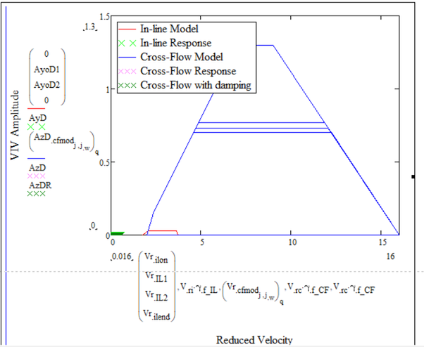

The previous worksheet is converted from the Mathcad 15 version.
Here I'm attaching the original worksheet of Mathcad 15 for reference.
Snapshot original plot is taken from a worksheet in mathcad15.

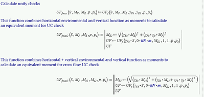

I converted the MC15 to Prime6 format, but the sheet uses a lot of features not supported by Prime (List Boxes, Data Tables) and for reasons unknown to me units in simple definitions are not converted to units but are treated as unknown variables (maybe because the are connected to the numbers via an explicit multiplication and not an implicit one).
So it would be a lot of (too much) work to make the Prime sheet usable.

I faced the same problem. There is an area where defining a unit and conversion are made in version 15. I've tried to expand the "unit" area and delete all unit conversions. It works for me. However, a few units in the formula/result (e.g. kNm, MPa) of the worksheet need to be changed.
Hope this would reduce the work.

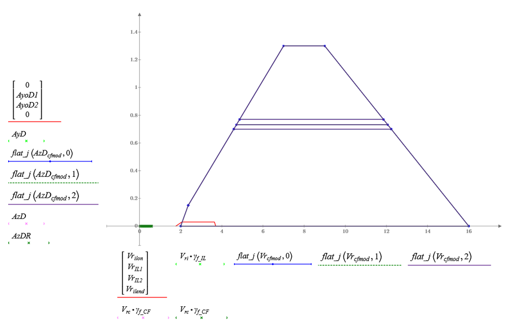

If you want to check the effect of one index, such as j. however, j=0 to 8 is almost same.
