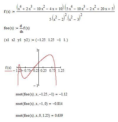

  Hello Everyone.
  From :
       Plotting local max-min-points ?
           Thanks in advance.

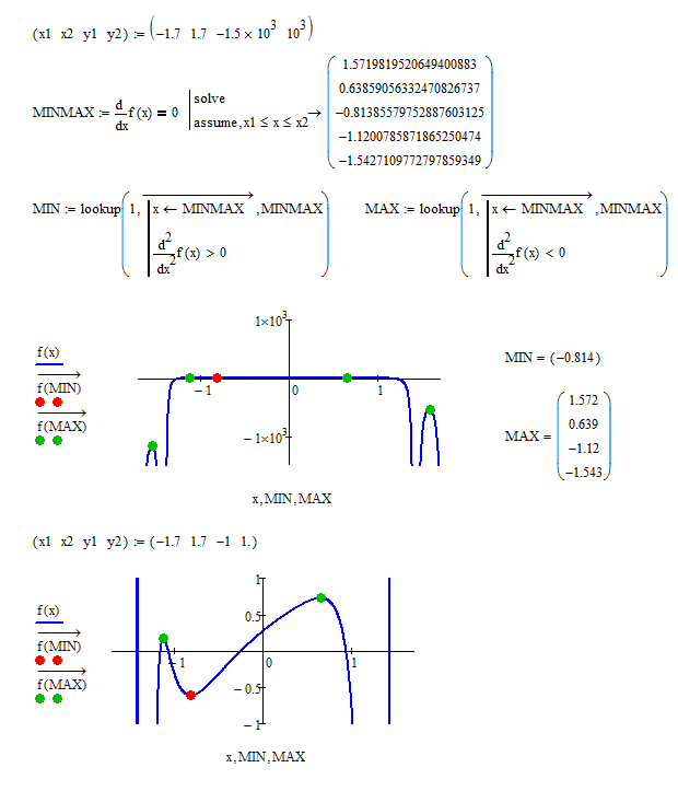

Here's a slightly different approach:
Unfortunately the more direct and logical
does not work in Mathcad - muPad is not capable to find the solutions.

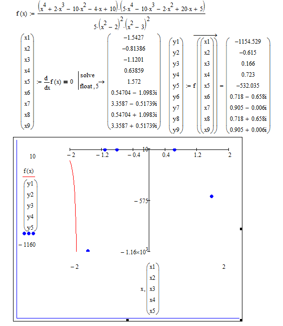

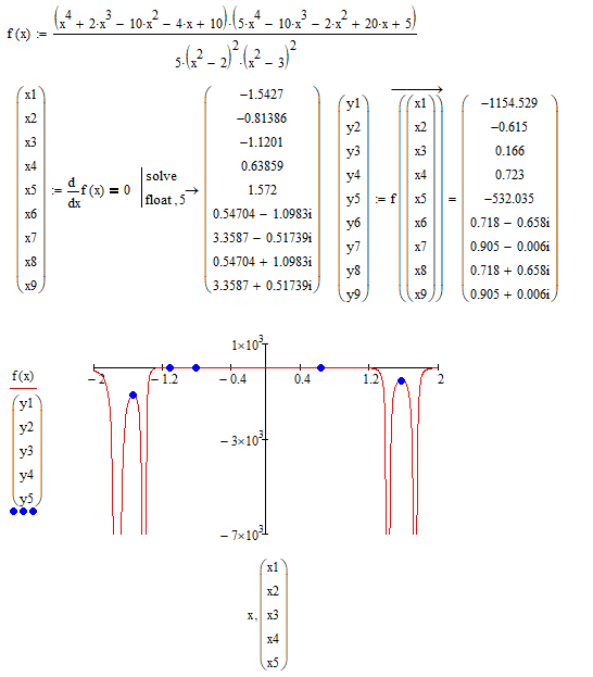

Set a function that is the derivative of f(x).
Use the root function on this derivative within a range to determine unique roots.
You now have enough info to plot the points.

Many thanks both of you, Valery.Smiley HappySmiley HappySmiley Happy And I still have a query : "How to prove what point is local min-point ?

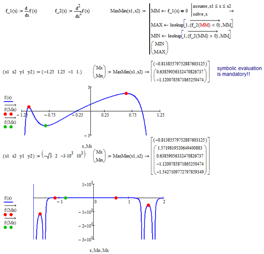

Some basic calculus (see Werner's application):
  • First derivatives of a function are zero at inflection points (maxima/minima),
  • The sign of the second derivative at the inflection point indicates minima (second derivative positive) or maxima (second derivative negative.)
(To:lvl107)

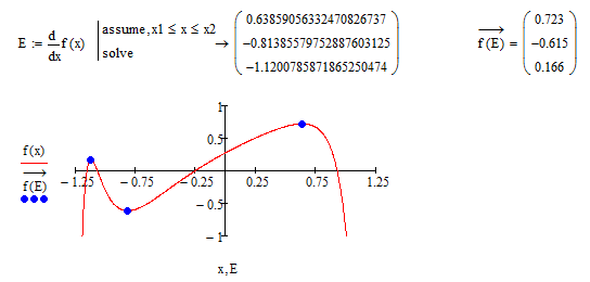

In case of this function Mathcads symbolics is capable enough to give you al solutions, so you should use it.
If your goal is to limit the results to x1<x<x2 you may use the "assume" modifier.
