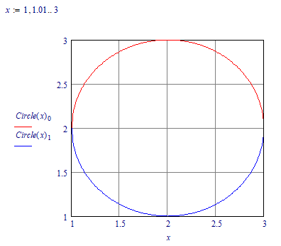

Not entirely. Yes, you have to describe the relation between rho and E, but.
You have to realise that for every value of rho, there are 0, 1 or 2 values of E that describe the outer perimeter of each of the shapes you want to draw on the graph.
Let's take a simple example: how do you draw a circle on the x, y plane. It can be done like this:
This describes circle with radius 1, and the centre is at x=2, y=2.
For each value of x, two values are calculated.
Now we can run x from 1 to 3 and plot the two components of Circle().

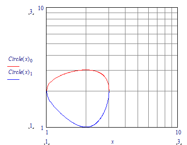

If we now change the axes of the plot to log we get:
If you want to convey the impression of a single curve, you can change the blue trace to red.

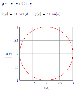

There is an alternative way, using another parameter, but I don't know if you (can) have that in your example. Anyway, for a circle it can go like this:
And with log scales:

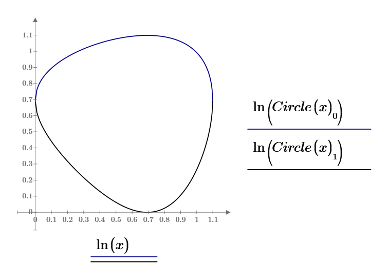

But would you please, show the same example, but in Mathcad Prime?
It looks like that you solved your example in Mathcad 15.
Best regards,
Sergey
LucMeekes
(To:Sergey)
No, 't was Mathcad 11.
See attached for Prime 4
