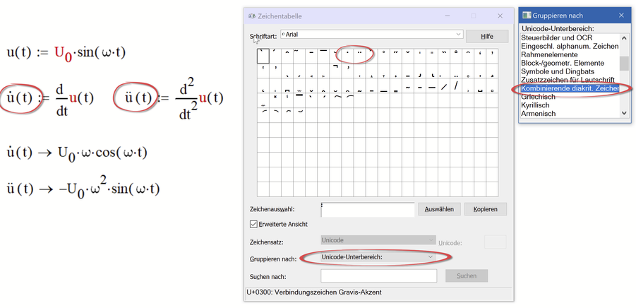

how to write one or more points overlapping the function to be derived, instead of one or more apexes
Can you give an example or describe in more detail what you are talking about and what any prefix operator would have to do with it?
You are not talking about showing points on the graph of a function instead using just vertical markers, aren't you?
Or are you talking about Newton's dots-notation of a derivative?
Here you would have to use Windows's character map, group after Unicode and chose the section with diacritic characters.
Use U+0307 and U+0308 for one and two dots. Not sure  how to create higher derivatives (e.g. three dots in triangle shape on top of a variable name).
In languages where umlauts (ä,ö,ü) are used (German, Turkish, ...), the use of ü can be misleading. Equally if not more problematic is the Newton notation for the first derivative of a current function i(t).
The ISO-80000-2 does not address this issue and explicitly specifies the point notation only for the first and second derivative as permissible notation if the independent variable is time. I find this restriction to the meaning of the variable as time clearly too restrictive, because this notation is generally quite common for derivatives with parameter representation.

BTW, are we talking about variable names in math regions or just text in text regions?
-MFra-
(To:Werner_E)
I was only referring to math regions. Thank you.

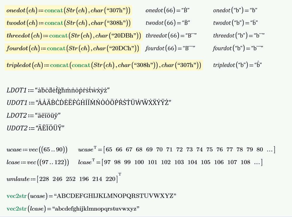

Following on from Werner's comments, here's something (modified) from a Unicode worksheet that I wrote a few years ago.  It's in Mathcad Prime 10, but I think it should port to Mathcad 15.
For those not familiar with diacritical characters, they effectively give an application's screen drawing code instructions to "backspace" over the preceding character and overstrike that character with the diacritical character.  Consequently, to delete the overstruck character entirely both the character and the diacritic must be deleted.
In some rendition systems, diacritics can be combined; in the triple dot case shown above, this means deleting three characters to delete the overstruck character.  Diacritics can also be confusing when moving the cursor across a character - usually, two movements are required.
NB: In Prime, To make use of a single- or double-dotted character, copy the string output, paste it into a Math Region, and delete the quotes.  To copy any of the overstruck characters to a TextBox,  copy it into the Find Box, deleted the quotes, and then copy/paste the overstruck character into the Text Box.
Stuart

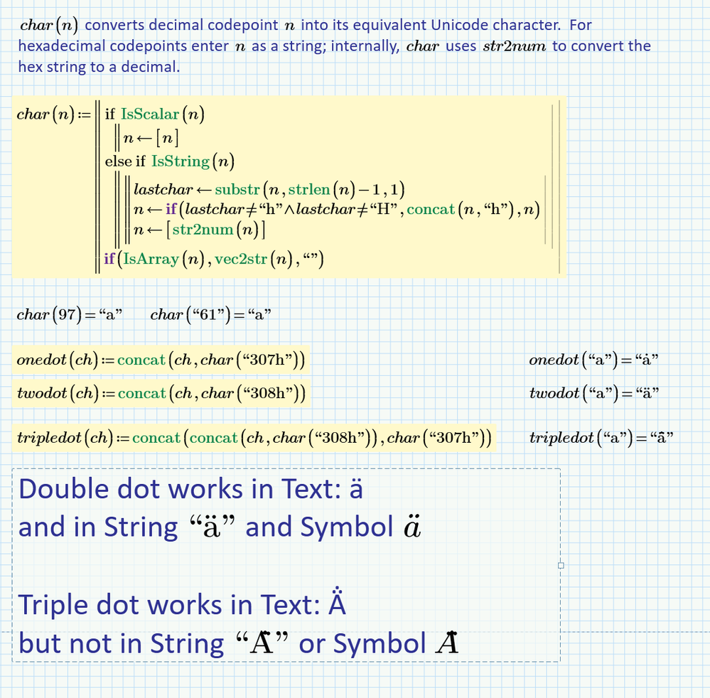

Having seen @Werner_E's comment about Arial font, I thought, "Why not? It's 0500 hrs, and I can't get back to sleep".   So, ...
It's a shame about all of the ones that worked italicising the triple-dot, and I hate to gainsay Werner, but I find Arial's triple-dot a little bit too close to the 'a'.
I tried several other fonts, but Cambria and Times New Roman were the only roman fonts I tested that showed a triangular triple-dot.  A few others got close, but not enough to win the stuffed bear.  I had hopes for TeX Gyre ScholaX until I tried the capital 'A'.  STIX Two Math looks good - if you ignore the chimney stack effect capital A and the vertical space the font covers.
Mathcad Prime 10 worksheet attached.
Stuart

Using the capital Y as posted by @-MFra-  I guess the font does not matter as it looks undesirable. I just tested Times New Roman and Arial - here with the diaeresis (two dots) in MC15
Some fonts contain already some characters including the dots. But still not that big dots as @-MFra-  had shown.
I used your "char" in MC15 and all strings are in Times New Roman. Nonetheless some are shown without serifs even though they look 'right" in the character map app. Not sure, why
This is how it looks in the Character Map
Copied to Mathcad (Variables and Constants, both styles use Times New Roman)
Conclusion: There seems to be no really satisfying solution except to create the characters yourself with a font editor (or by chance to find a font somewhere where someone else has created the desired characters satisfactorily).

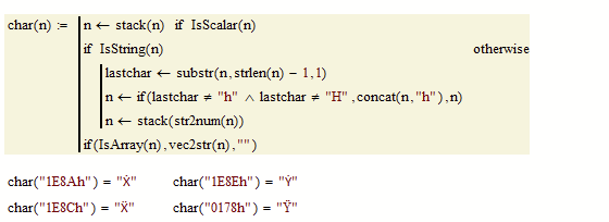

Here are the functions I use.
Plus the updated 'dot' functions and alphabet strings.
Stuart

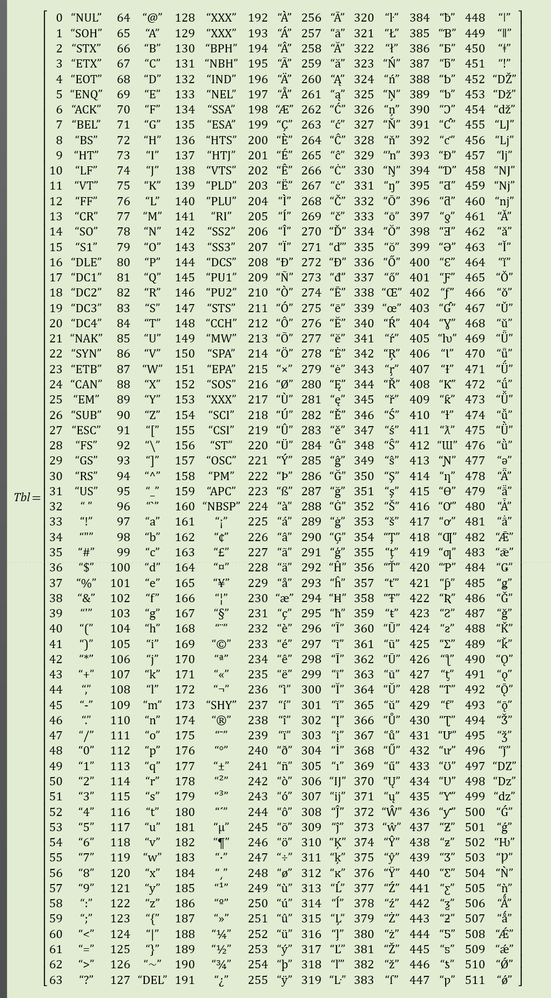

Revised version of worksheet uploaded.  This new version includes some of my, slightly modified, set of string functions.
StuartBruff
(To:StuartBruff)
Forgot to add ...
The extra string functions are only there to help generate the character table at the end of the worksheet, which was directly copied from my original 'Unicode' worksheet.  Not all of the string functions are necessary and most are overkill for what they do.  However, they had other uses within the original parent worksheet.  It wasn't worth the hassle of cutting the useful functions from the herd and taming them.
