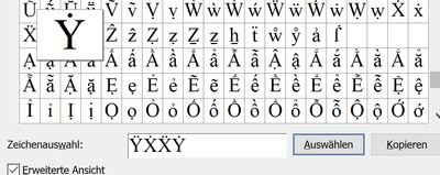

I remember that a few years ago, a post was published asking how to write one or more points overlapping the function to be derived, instead of one or more apexes, but I can't find it, so how can I do it especially for MATHCAD 15? the difficulty lies in placing the dots on the functions, then we proceed with the prefix operators and the like.

Or are you talking about Newton's dots-notation of a derivative?
Here you would have to use Windows's character map, group after Unicode and chose the section with diacritic characters.
Use U+0307 and U+0308 for one and two dots. Not sure  how to create higher derivatives (e.g. three dots in triangle shape on top of a variable name).

The dots are barely visible in font size 12. Enlarging it then messes up the whole page. Isn't there a cooler way?

Yes, there was also a reason why I chose the Arial font and a lowercase letter without ascenders. 😉
It looks ugly using TimesNewRoman and a capital letter.
You may use a different style for your special variables, but I guess it does not get much better: Here Y is in style 'User 1' set to Courier New, 12 pt, while the rest is at it defaults (Times New Roman, 10 pt).
You can try to use different fonts and see if it looks better but many fonts don't support diacritic characters and will show the dots to the right of the letter and  not above it or show them not at all.
Can't think of an easy way to achieve the desired effect and I can't remember to have seen a better solution here in the forum in the past (which doesn't mean a lot as I tend to forget things quite often)..
Of course you always can use a free font editor and modify an existing font according to your wishes. You may enlarge the dots  or even add letters which already have the dots on them at the size and position you like.
That's a bit of a work to do and if you share a worksheet using non-standard fonts you would have to share the modified font as well (unless you don't t share the Mathcad sheet itself but just a pdf with embedded font).

Using the capital Y as posted by @-MFra-  I guess the font does not matter as it looks undesirable. I just tested Times New Roman and Arial - here with the diaeresis (two dots) in MC15
Some fonts contain already some characters including the dots. But still not that big dots as @-MFra-  had shown.
I used your "char" in MC15 and all strings are in Times New Roman. Nonetheless some are shown without serifs even though they look 'right" in the character map app. Not sure, why
This is how it looks in the Character Map
Copied to Mathcad (Variables and Constants, both styles use Times New Roman)
Conclusion: There seems to be no really satisfying solution except to create the characters yourself with a font editor (or by chance to find a font somewhere where someone else has created the desired characters satisfactorily).
