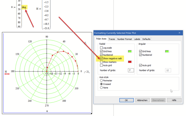

This is a very elementary question, but I cannot find a solution. I have two columns of numbers, the first (angles) goes from 0 to 90 in steps of 10, but I plot them in radians. The second  column is the measurement result at each angle, i.e. 10 values, the first being zero and the others are negative values down to -21. When I try to make a polar plot, I get the measurement values plotted in the 240 to 270 degree sector, and the radial axis goes from 0 in the centre to +21 at the perimeter.
If I try plotting in degrees, I get a bizarre scatter plot over the whole circle, but only 7 points are plotted.
How can I plot these data correctly?

But take a second look at my picture!
1) ALL 10 points are plotted and I even marked them with dots
2) Look closely at the radial scale! Because I checked "Show negative radii" the scale runs from -21 at the center to 0 at the outside. You can change those values at the appropriate placeholders at the right of the plot.
If you turn off "Show negative radii" (which is the default setting), the radial scale runs from 0 in the center to +21 at the outside. And of course the value of -6.2 for 60° is seen in the plot as +6.2 at 240° (the extension in negatives of 60 degrees).
This is shown below in the plot on the right side.
If none of these is what you expected, can you show which kind of plot you'd like to see with the data provides.

Thank you. That is the solution.

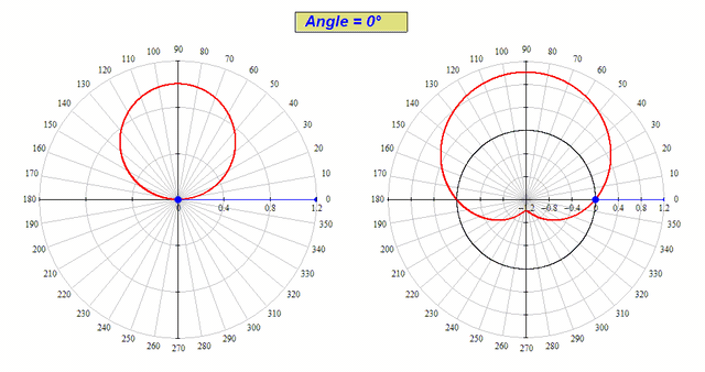

I personally find polar plots where zero is not in the center very irritating and therefore usually avoid the option of showing negative radii.
In the plot on the right I have drawn the zero radius in black and did not put -1 in the center, but rather -1.2. Therefore the curve is not a standard cardioid.

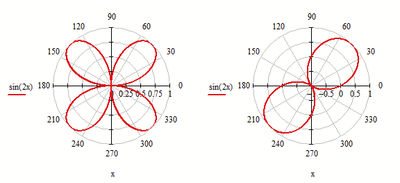

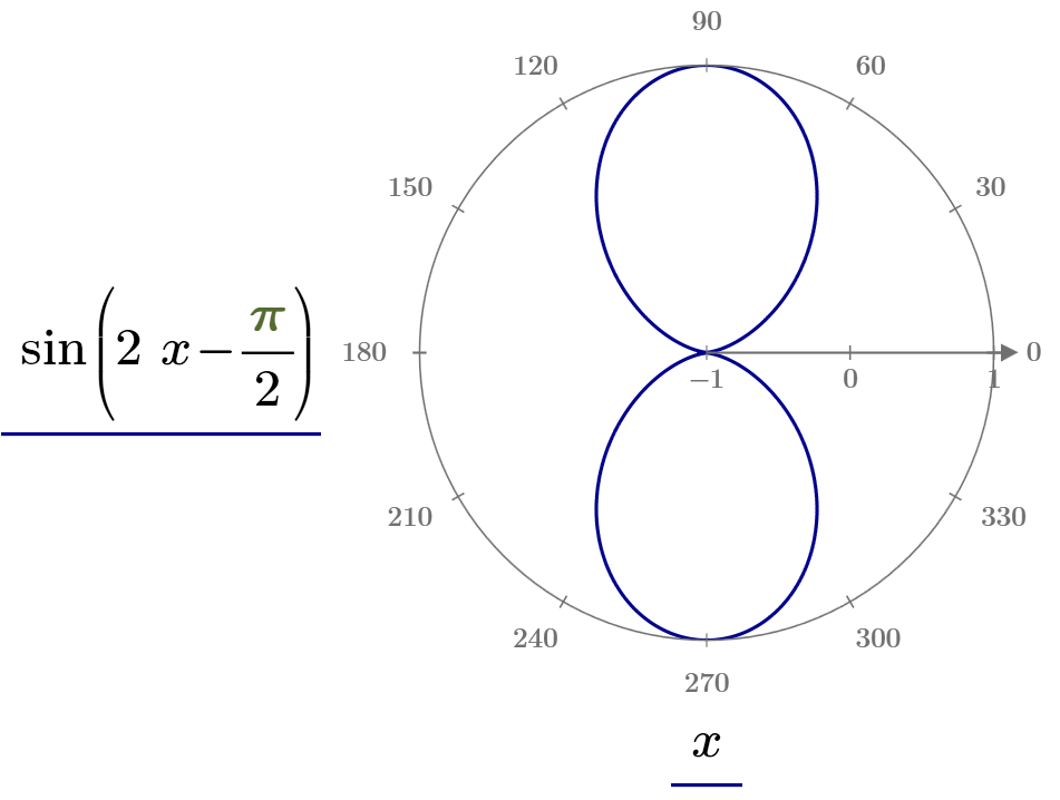

If you double the frequency you get the four-leaf clover in a normal polar plot and the figure eight if you allow negative radii.  You can rotate the figure by applying some phase shift (as Valery already had shown).
Another way to get a figure eight is using the absolute value of the sine. Actually what you get are two circles:
