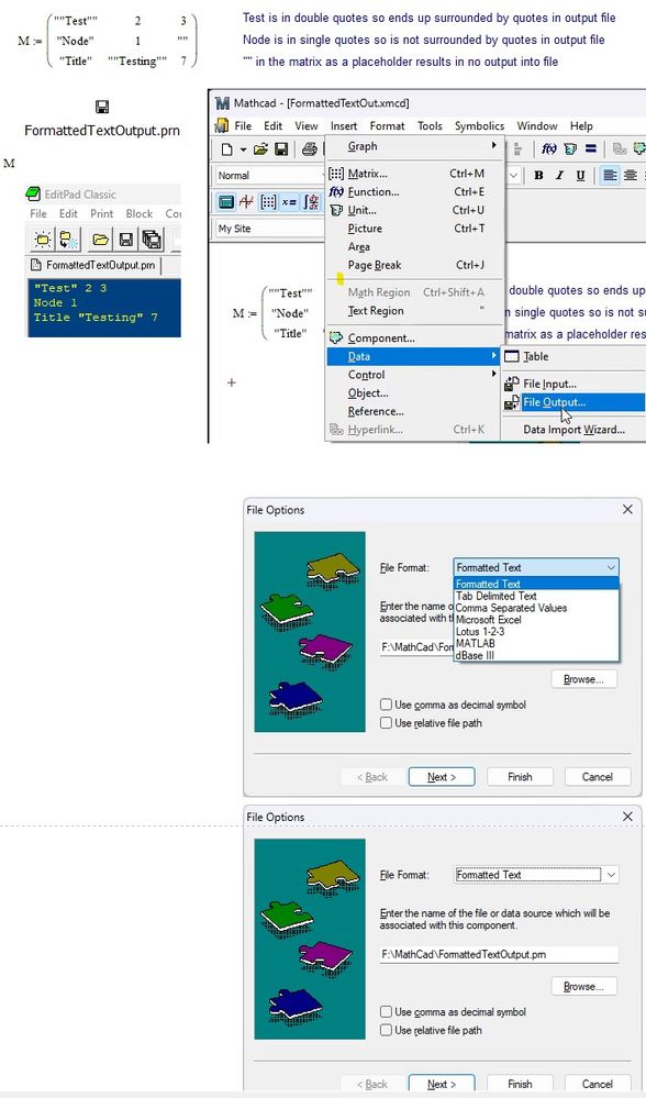

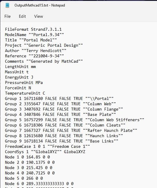

First what was possible in Mathcad 15
Mathcad 15 had a data file export component.
This data file export component when you selected "Formatted Text" did four things
1) Text in double quotes ended up in text file with single quotes
2) Text in single quotes lost the quotes in the text file
3) Adjacent quotes "" to indicate no data did not appear in the text file.
4) Numbers stayed as numbers
In this way a very large text file could be generated from a Mathcad matrix quickly
Here is a simple example.
Primes current file output functions cannot duplicate this Mathcad 15 data components behavior.

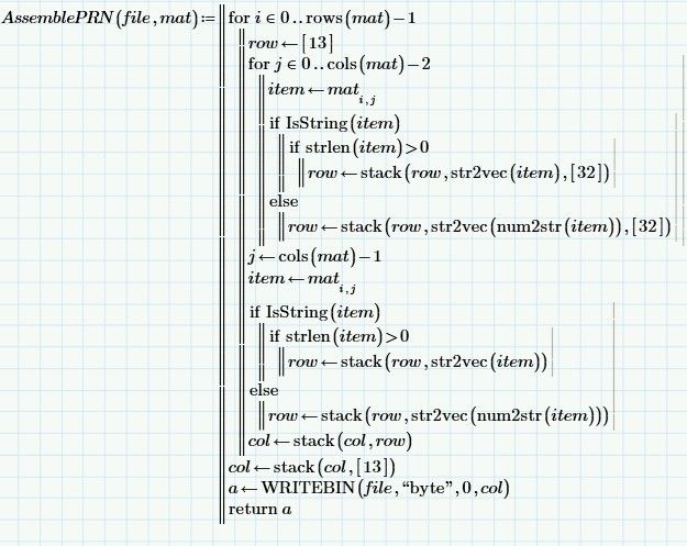

Second how I got around the limitation.
I created a function that uses str2vec to create a giant column vector of ascii characters, but it is agonizingly slow.
For instance a Prime file with a matrix of 99514 rows x 8 columns with 4.5 million characters takes about half an hour in Prime to calculate and save the large column vector.  The vector is saved by WRITEBIN function.  Half an hour for hundreds of parametric files is a long time I am not looking forward to.  Hence my call for help.
Can anyone speed up the function or suggest a faster method of creating the file in Prime.
This is what the finished finite element model looks like generated from a few parameters using Prime.
My aim is to save steel tonnage in portal frame buildings.

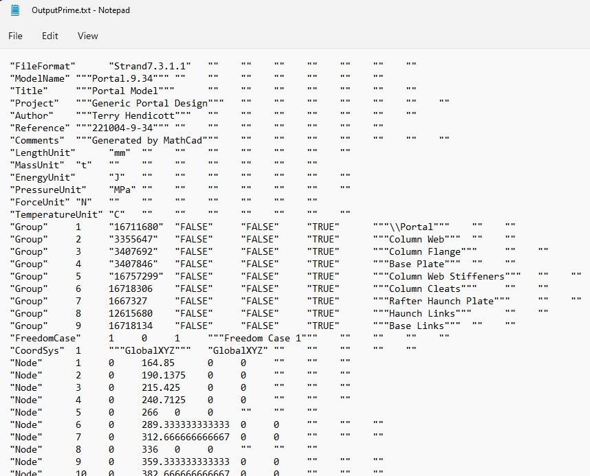

Step 1
Save a text file with Prime this gets a text file that can be imported into Mathcad 15
The file has single quotes for single quote entries
Triple quotes for double quote entries
Look at the "Group" lines and you can see the Prime text saver is random in treating numbers as text or numbers but no matter this workaround negates that.  Who knows how many times it does this in the large file.
Step 2
Run a Mathcad 15 file with only two statements using the built in file input and output components
This gets a file with single quotes gone and triple quotes as double quotes.
Note this fixed the group statements and codes are now integers like they should be.
Numbers are accurate not like WRITEPRN() statement in Prime.
Step 3
Replace in an ASCII editor the double quotes to single quotes and save.
Step 4
Run the FEM program and import the file.
Round trip time a couple of minutes.
A tedious kludge but it is going to save hours.
Cheers
Terry

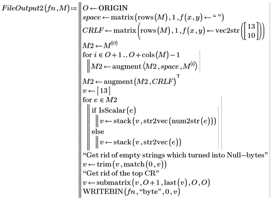

I, too, can't think of anything else than creating the large vector and using WRITEBIN.
I won't claim that my function in the attached file would be any faster than yours, but you sure have the large data at hand to testdrive it.
It looks to me that your version adds a blank line at the top of the output file. If thats OK for you you can change in my function the ["dummy line"] for [13,  10] and delete the submatrix command at the end.
Of course you may also change my CR LF (13, 10) for CR (13) only if that suits your needs better.

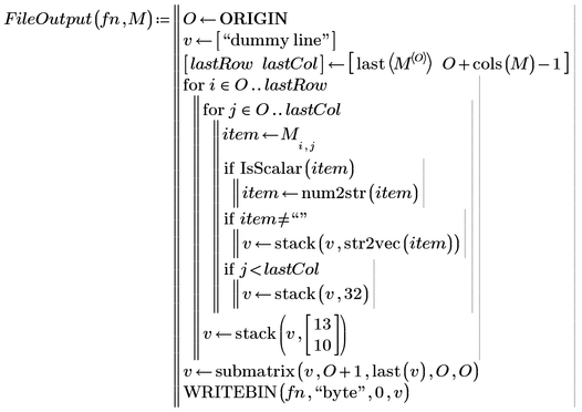

Hi Werner
Have been doing some testing and examination.
There are nearly 800,000 items in the matrix.  Majority of them are numbers.
AssemblyPRN() uses only one branch if/else test for this majority of items as numbers
Strings either "" or with values like "Quad4" only have to pass two if tests.
AssemblyPRN() takes 27 minutes to run.
FileOutput() performs three if tests for each item no matter what the item is so runs for a longer time
Currently at 1 hour 30 minutes and still not finished.
Think I will look at the Prime API over the next couple of days but not hopeful.  The API is set up to pass a matrix of numbers or individual strings as variables.  Does not look to cover a matrix made of strings and numbers?
Cheers
Terry

Here is a version where only one "if" is left.
But I fear that the operations done on a huge matrix M to create the new(!) matrix M2 may more than compensate for the saved if-statements. Guess that the additional memory consumption should not be a problem for Prime (it could have been a problem in real Mathcad).
Give it a try if you feel like doing so.
If its no problem that empty strings result in Null bytes you may remove the "trim" line
if its no problem that the file start with a CR(13) you can delete the "submatrix" line
EDIT: A first timing test is not promising but its just using your 3x3 data matrix and so may not be a good indicator for how the functions would scale for larger matrices...
EDIT2:
I guess its not necessary that you test the new function with your large data matrix. I stacked and augmented your demo matrix to create just a 30x30 data matrix and here are the results:
It looks that so far your AssemblePRN is by far the fastest solution 😉

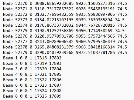

Hi All,
Really want PTC to realize how useless WRITEPRN is
The beams are connected to two nodes given by the numbers in the last two columns
Here is how WRITEPRN interprets this.
Beam 1,2,3, & 4 all now go between nodes 17320 and 17800 this is not what is intended?
Node 52380 is written five times?
WRITEPRN() looses valuable information of the FEM model.
Cheers
Terry
