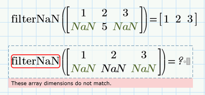

Prime bug with "filterNaN"
  • June 22, 2023
  • 3067 views
To whoever may be interested
June 24, 2023

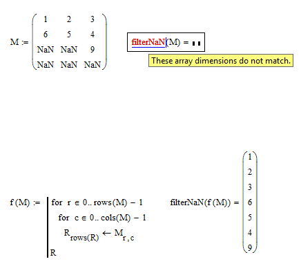

Mathcad 11:

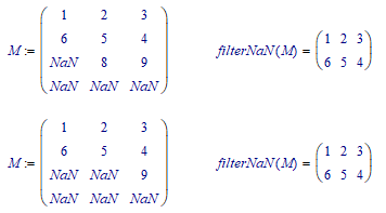

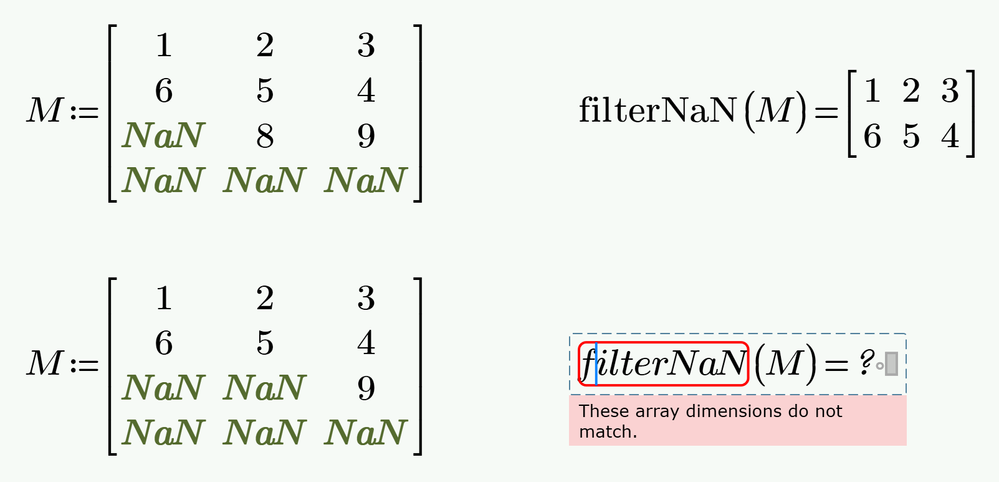

PrimeExpress4 (with a correct implementation of the filterNaN function):
Werner_E25-Diamond IAuthor
June 24, 2023

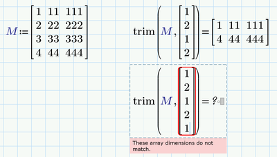

The built-in filterNaN in Prime4 throws the same error as in P9.
Actually the bug is already present in Mathcad 15 😞

I'm responsible for the implementation of the filterNaN function in the PrimeExpress library.
Note that it has this peculiarity:
(It doesn't do vectors, yet)
I now see how to mend that (the dirty way)
