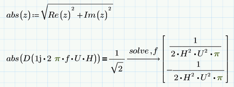

(To:JH_9781973)
You may redefine the "abs" function:
