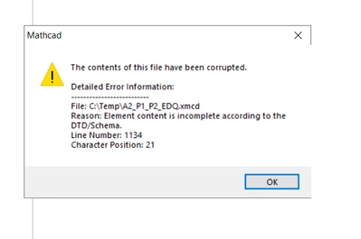

The attached file is corrupted - Element content is incomplete according to the DTD/Schema, Line number 1134, Char Pos 21.
Can some one offer suggestions on how to fix the file?

I simply loaded the file in a text editor (I use Notepad++), located line 1134 and deleted the whole region this line was in. That is the section starting with "<region ..." in line 1112 up to line 1146 with the closing "</region>".
Yes, its rather bold and there sure may be more sophisticated ways, maybe a way to detect the actual cause of the error and repairing it without having to get rid of the whole region.

I edited the file and deleted a corrupt region. So obviously there is now missing something compared to the original.
Hope it helps.

Thank you kindly.  If you don't mind, how did you identify the corrupted region?
