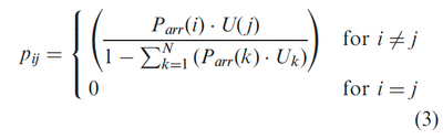

I'm doing assignment related to passenger transit probability which indicates the probability that a passenger chooses to travel from floor ''i'' to the floor ''j''. This is only 4 floor building.
''P_arr'' is an arrival rate on each floor and ''U'' is a dedicated population on each floor.
This is a formula which I have to use.
And this is my initial matrix from Word for calculation's
Does anyone know how to create a matrix 4x4 like below from vector ''U'' and vector ''P_arr"?
This is actual case study from one of journals and there are results for this if this helps a bit
I would be very grateful for help
Greg

Or, as long as you keep the vectors P.arr and U the same size, you can do without the explicit indexing:
and with that you can:
Note that you cannot assemble it into a single expression, due to the vectorization(s) needed.
