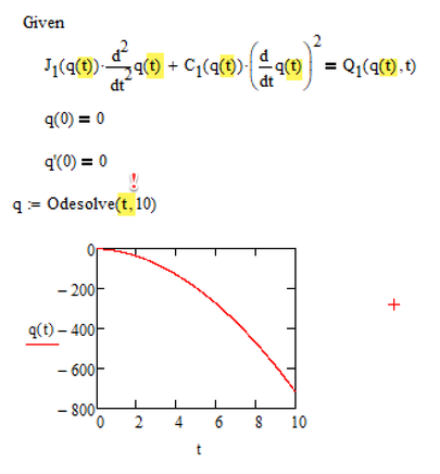

I have been trying to solve this equation however no matter what I tried, I couldn't come up with an answer.
All the functions appearing in the differential equation is defined but at the end, it can not solve.
What is the problem?
I also included the file I am trying to solve.

You do  not appear to have a function q(), but in your initial conditions you state  q(0)=0 and q'(0)=0.
That should be at least confusing for the Mathcad solver.

I am trying to get a q vs T plot. However, as in the equation, T is a function of dq/dt.

You are still using q as a function and you have NOT defined that function. So dq/dt leads to nothing.
Once you have defined q(t), you can refer to its derivative, but then use dq(t)/dt, or (in a solve block) q'(t), but not dq/dt...
(To:Alperc)
Are you looking for something like this?
